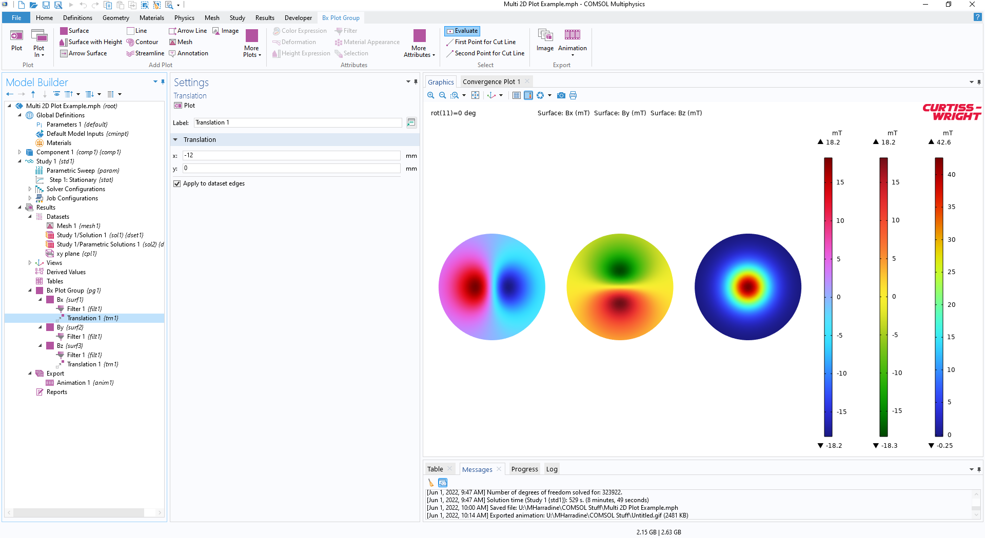

You can have mutiple 2D plots within the same 2D plot group. In order to display them in an array, you can use the "Translation" sub-node for the individual 2D plots to move them within the common plot window so that they all display and step through with a common time step.
The time can be stepped through with the controls at the top of the Plot Group settings pane.
Mark

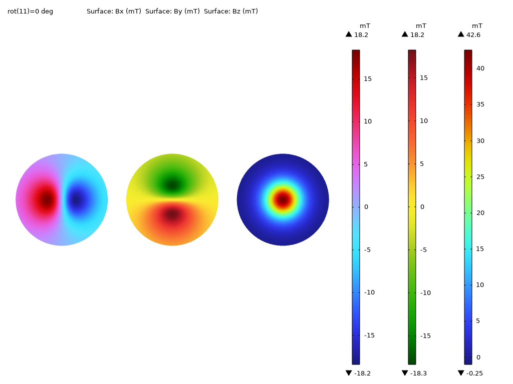

I have added an animation and an image to illustrate. This particular model is stepping through a rotation of a permanent magnet, the 3 plots sow the Bx, By and Bz components over a surface, but the same strategy could be applied to a time-dependant study.

An alternative to using Translation subnodes is to use the settings in the Plot Array section in 2D and 3D plot groups.
