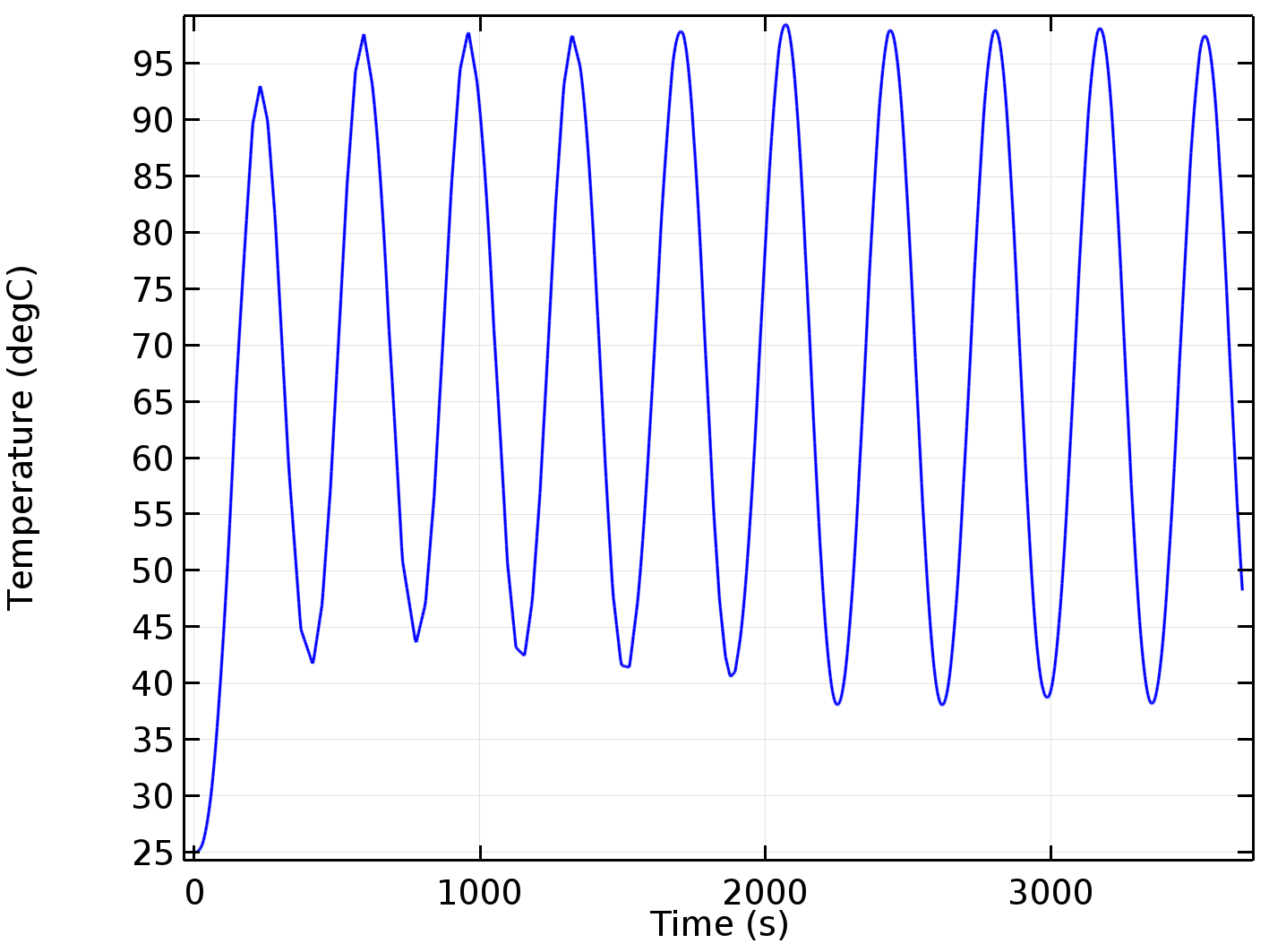

I'm doing a time dependent study of temperature versus time. I'm running for 3600 seconds with a step size of about 1 second. Everything looks good, except when I make a 1D plot of temperature it looks like COMSOL doesn't plot all the points. See attached. It looks like COMSOL decimates my data and
plots only, maybe 100 points. All thousand points are really in the data set. I see them if I make a table, but they don't appear on the plot. If I decrease the stepsize of the simulation, the time graph looks just a coarse. What Gives? I don't see any option on 1D Plot Point Graph for specifying decimation. No doubt it's some arcane option I missed, but I really have looked. Thanks in advance for pointing me toward the answer.
