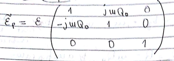

In the figure found attached, Q is the magneto-optical constant, and m is the normalized magnetization, that is, it assumes values between 0 and 1.
Thanks.
