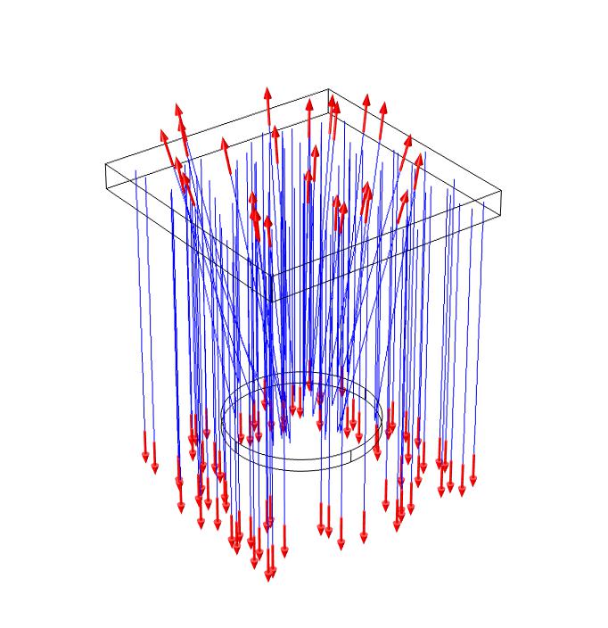

I'm trying to measure the phase of a bundle of rays that are reflected from an aspherical surface.

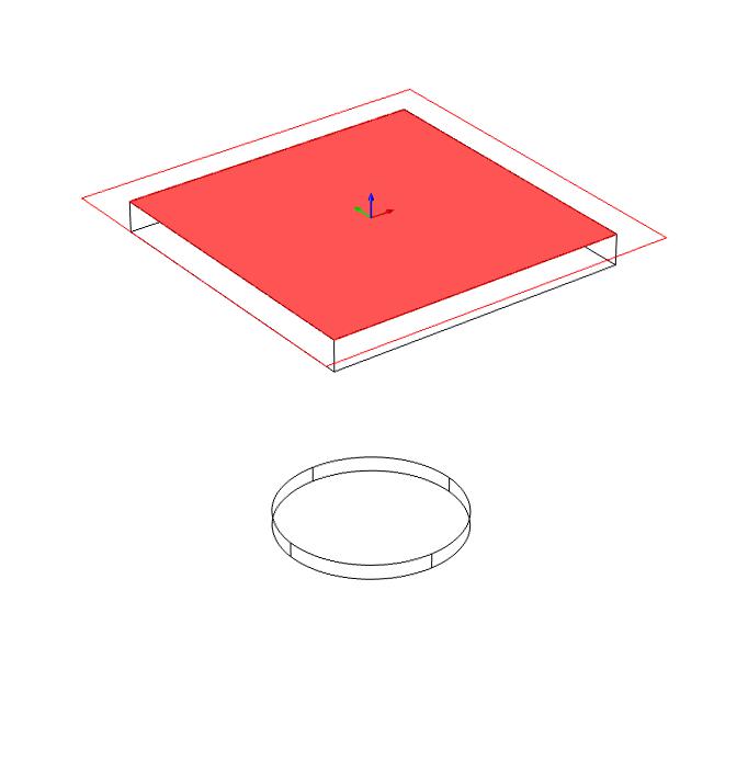

File 1 attached is the ray tracing and the red plane in file 2 is the surface on which I want to know the phase of the rays.

Hi Andrey, the phase is a property of the rays, rather then the geometry, so when you try to evaluate it on a geometric entity, it fails.
The solution is to define a cut plane where you want to evaluate the phase, then use the Poincare Map plot type to create a spot map of the phase. The Poincare Map plot type allows you to plot quantities defined only on the rays at the intersection point between the rays and a geometric entity. You can refer to the attached (V5.2) model to see how to do this.

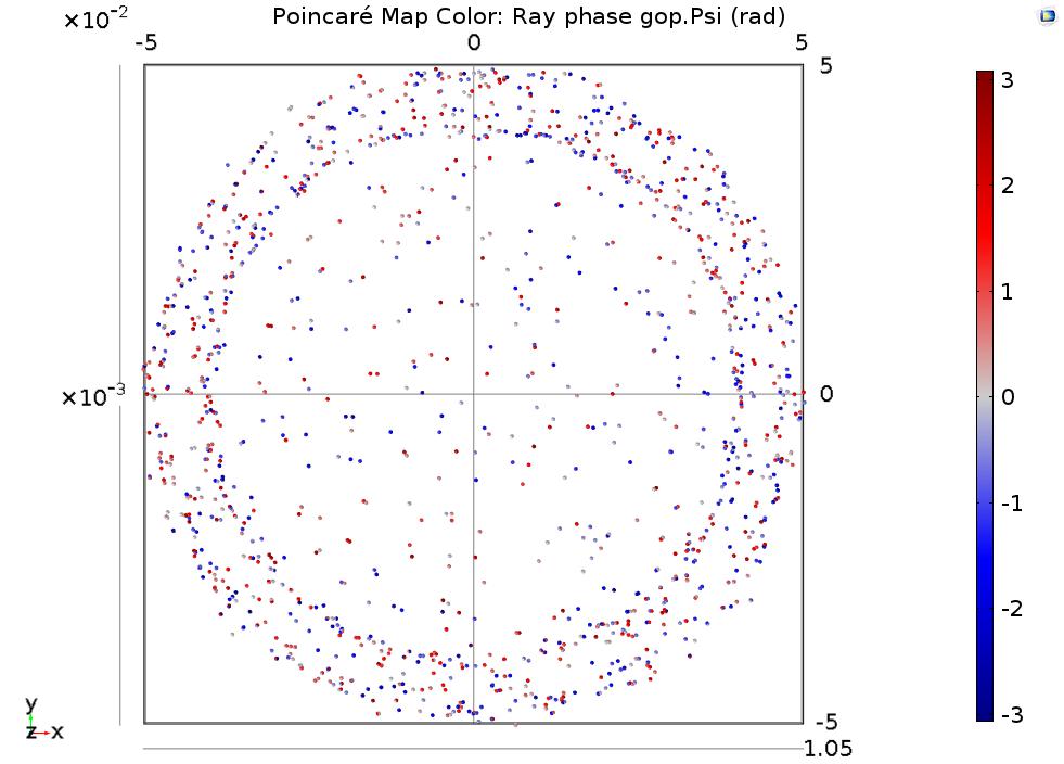

I tried the poincare map and it works well when I'm using the color expression and plot gop.Psi, but the results are a little bit weird, I expect a symmetrical phase map and it is not symmetrical (see attached file).
Maybe, has Ivar said, I need a reference ray. How can I define a reference ray that will intersect with the middle of my "cut plane"?
