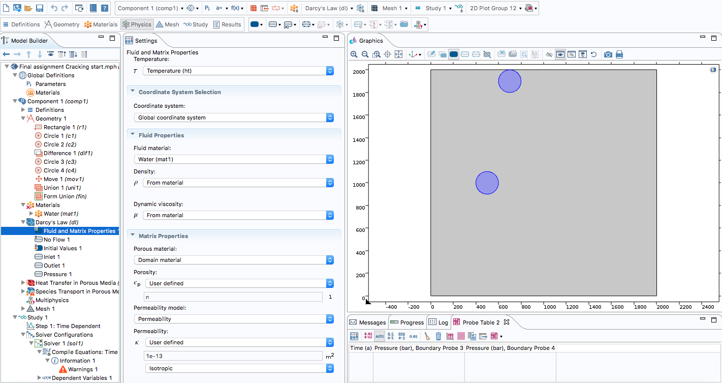

In order to simulate this I would like to overwrite the locked permeability map of the reservoir with a circle around the well that has improved permeability. How can I make this happen?

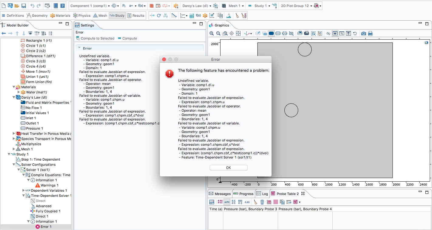

In the attachment I have placed a screenshot of what I have now, with the permeability of the two circles adjusted to 1e-13 (the permeability of sand, that will most likely fill up the gaps). During running, the error in the second attachment pops up. I tried meshing the two circles, and also tried to make a union with the reservoir (the square). Also I figured that the upper circle might just pass the boundaries, so I made sure it is within the boundaries of the reservoir. None if these issues fixed the problem though.
