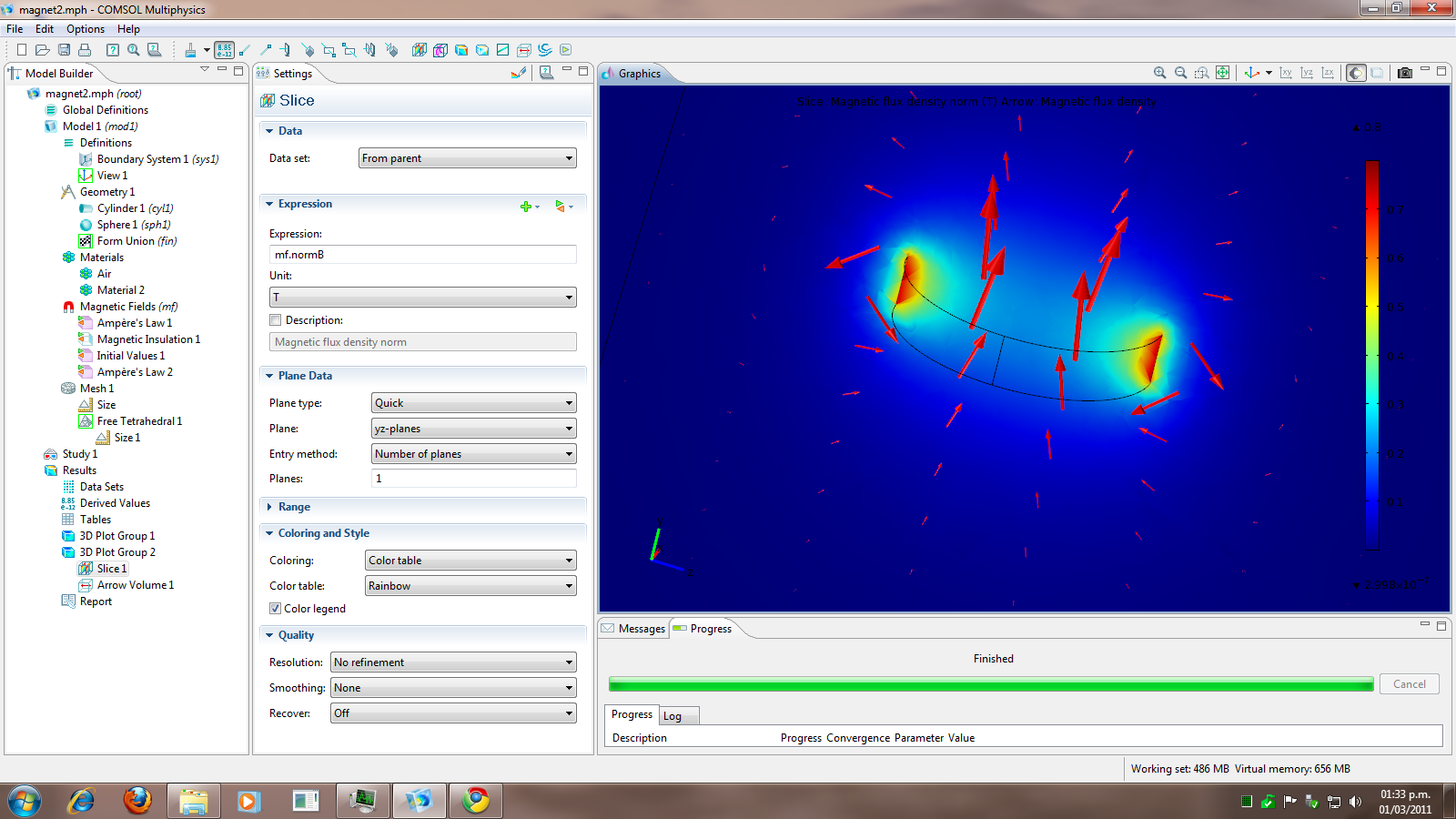

Posted: 1 decade ago 01.03.2011, 13:14 MEZ
Hi, Ivar. I followed your instructions from your second post but I still think there's something wrong somewhere, or maybe my electromagnetism is a little rusty. I'm attaching the file of my magnet. You'll see the field is stronger at the edges of the magnet when I think it should be stronger everywhere inside the magnet, with the rainbow gradually turning to blue on the outside.
Posted: 1 decade ago 01.03.2011, 14:47 MEZ
Indeed, one could believe so.
BUT I suspect that it's your mesh density that is also playing you a game there.
If you select the magnet itself and add a "tet" extremely fine mesh and then solve, you will see that the red region concentrates on the upper and lower edge (as these are singularities) and the external boundary.
Its more apparent if you turn off the smoothing and use a raw No Refinement Resolution for the graph. One should always check the shapes in raw mode, smoothing is nice but you can quickly be fooled by artefact's
If you round the edges off with a fillet radius this effect will reduce somewhat but the .

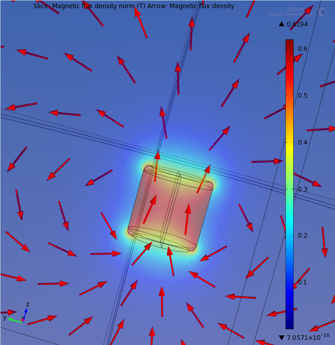

Posted: 1 decade ago 01.03.2011, 16:41 MEZ
This is what I'm looking at. I followed your instructions and created an "Extremely fine" tetrahedral mesh for the magnet and left Mesh1-->Size at "Fine."

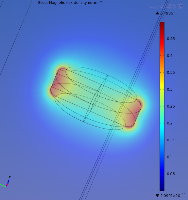

I'm afraid regarding the singularity problem, I have the similar question. Is it simply because of the corners that caused such nonuniform distribution of the field strength in the magnet? I attached a similar picture of the cylindrical magnet resulted from my simulation. Thank you very much!

Hi, Ivar,
I tried your method based on your model but still get more red on the edge. I don't understand and am totally confused. I'd really appreciate if you could give me some help on this. Thank you so much!

However, when the geometry's aspect radio gets close to unity or greater, it becomes more uniform. Now I'm confused if it's physics or it's artifacts due to the simulation boundary setting, etc.

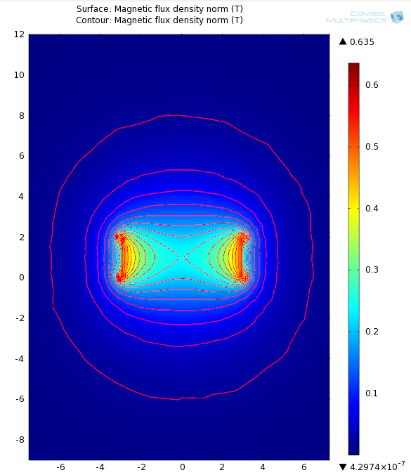

I have been out of houise for some time ;) for me the field concentration ou nthe outer part of the coil is normal, in the sens that depending on the physics and BC you use you will have (or not at all) the effect on the current density by the field itself, that will push the current to the edges (skin effect). this is also very frequency dependent. Mostly with simple analytical means one forget these "2nd order" effect, even if they are often far from negligible.
But they can only easily be shown with tolls like COMSOL (and there are not many).
So sharp edges = singularities = partially wrong results for numerical reasons,
but current densities tending to increase at the outer border = physics applied correctly, and is a "feature" of a bulk coil

Hi, Ivar,
You said "but current densities tending to increase at the outer border = physics applied correctly, and is a "feature" of a bulk coil ".
Does this apply to permanent as well? I was simulating a piece of permanent magnet without any coils. Could you please provide me more information on this? Or could you please guide me to some reading materials for better understanding of why concentrated B at border happens? I really appreciate your help!!! Thank you so much for your quick response!
