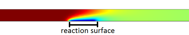

I am trying to estimate some parameters (Kon, Koff) for a surface reaction in a microchannel. The surface reaction is happening along a small part of the boundary in a 2D space. i have the surface reaction module set up to monitor the surface concentration of the formed species (cs_AB).
