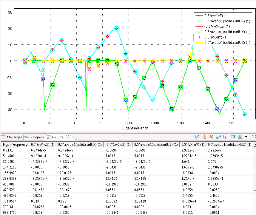

indeed by default there is no angles in 3D solid. in V4 you can use the "Curl of displacement U", in other words, for small angles up to 2-3 degrees ( at most 5-8[deg], above you should use a quaternion approach to get correctly larger angles)
Thx = 0.5*(wy-vz)[rad] Rotation x (Antisymmetric displacement velocity tensor)
Thy = -0.5*(wx-uz)[rad] Rotation x (Antisymmetric displacement velocity tensor)
Thz = 0.5*(vx-uy)[rad] Rotation x (Antisymmetric displacement velocity tensor)
in V4 solid with spatial frame driven by the deformations, you must correct to:
Thx = 0.5*(wY-vZ)
Note the upper case X,Y,Z due to the spatial and material frame splitting and renaming
you can also write, in V4
Thx = 0.5*solid.curlUX
see example in the attached file, sorry I have only 4.1.0.185 today
