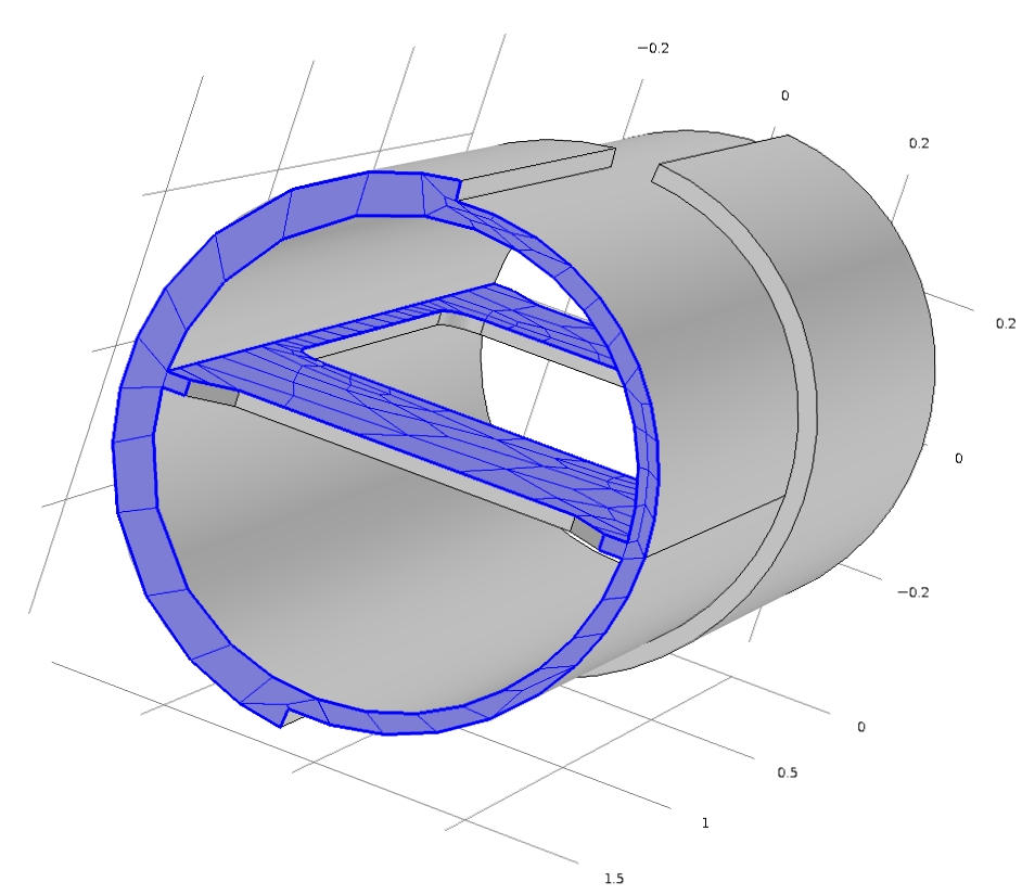

you cannot sweep mesh such a geometry in one go, for that you need to "cut" it up in block elements, this can easily be done in most CAD software, but splicing the volume into several bodies, you should do that along the radial cylindrical direction (at least 2 times for r) and along the axis (at least in the middle)
for me the minimum would be to have the twoexternal half shell cylinders, the cylindrical body in two sections, and the internal cross bar body. This internal cross bar might have to be meshed in thets, in anycase I would mesh itas the last item on the list

                                                    Thanks for the Advise Ivar,
Will give it a shot and update the issue. there still seems to be some misunderstanding tho.
I have "one" unit not an assembly, reason being that no matter how accurate I assemble the parts in CAD software (Inventor 11 in my case), comsol introduces gaps and steps on assembled interfaces.
again, i will import a simpler assembly and I will do as you suggested see how it goes.

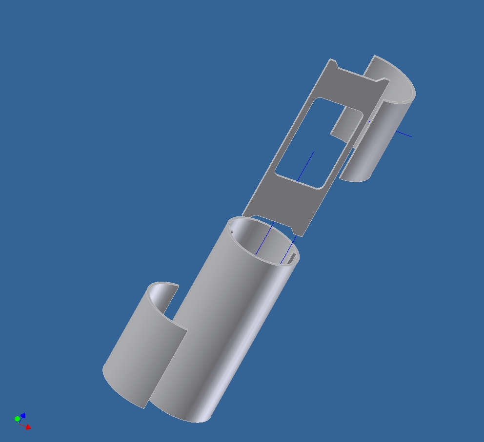

So, I did manage to mesh my model and I dont really like how i did it ,or actually how comsol wants me to feed in the model, and here's how:
I took Ivar's advice and made seperate-common-shaped partitions out of it (One big tube ,two half washer-like elements and one simple slab,see attached ) and assembled them in my CAD software (inventor 11) and exported the assembly As it was. (NOT an IGS or STEP just as an assembly file (*.iam).
Upon import to Comsol make sure to choose these options (in 4.1 version):
- Geometry Representation/ CAD import Kernel
* this option requires the livelink for a CAD software license and It is a more powerful modeling kernel than the default kernel in Comsol so it can handle geometries better
-Form an Assembly(Although it is one Unit), otherwise you will get errors in meshing cause by interfaces
so taking these steps I can not mesh my design , I think this is a huge drawback of Comsol not being able to handle these geometries, At the end it all goes down to your geometry, change your assembly in a way that it is made of common shaped elements and you will get a way with it.
hope my experience helps you guys, ill be openning new threads asking new questions thats for Sure! :)
cheers
