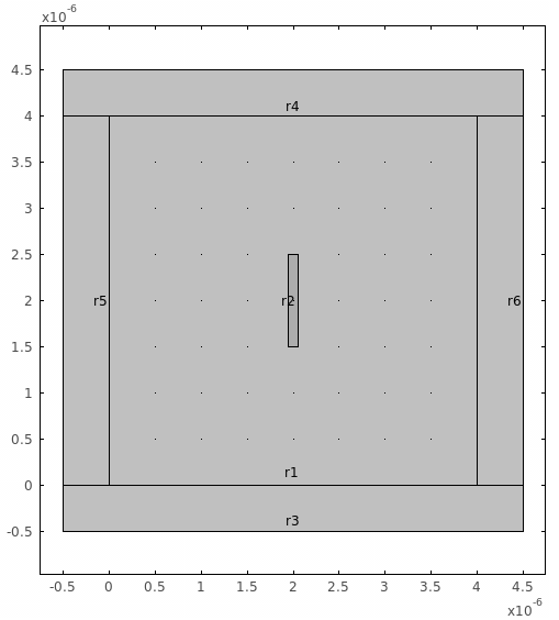

I'm simulating the absorption of a nanowire in vaccum. I started with a 2D model in the RF module. My geometry is a nanowire in vacuum surrounded by cartesian air-PML. I solved the problem for the scattered field. The incident field propagates along the y direction and is either x or z polarized.

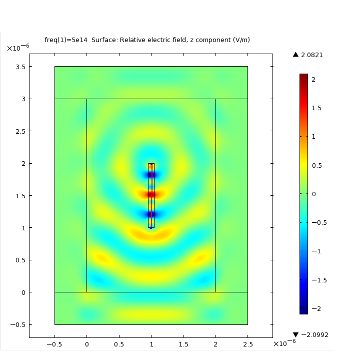

I have no problem with the x-polarization, however when I solve the problem for the z-polarized field, the scattered field is not well absorbed by the PML (see fig in attachment) and it does not change if I increase the size of the PML and/or the mesh size.
Can somebody explain why ?

I cannot say if this will completely eliminate your problem, but your PMLs don't seem to be properly drawn. I would suggest you to have a look at the tutorial model "Dielectric scattering" in which they do exactly what you are trying to do here.

I found that having the PMLs intersect eachother on the outside surface works well, you could also try putting a scattering boundary on the outside of each of the PMLs. I am also trying to model nanowire absorption and I was wondering what you were using to induce the electric field down the sample. I tried using a scattering boundary but this requires an open face without a PML, and for some reason when I tried using a port at the inner face of a PML it did not work.
