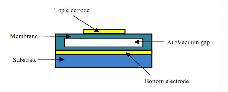

I don't understand how to setup Moving Mesh Physics for my cMUT model
any help please
any help please

Dear Shubham,
For the type of modeling being described in this thread, we would recommend that you use the Electromechanics interface available in the MEMS Module. In particular, the following example is a good place to start with learning this interface:
www.comsol.com/model/electrostatically-actuated-cantilever-444
And then, to see what other types of modeling are possible with the Electromechanics interface, see:
www.comsol.com/model/biased-resonator-models-3d-11748
Please note that the approach described earlier in this thread, of manually combining electrostatics, moving mesh, and solid mechanics is a "legacy" approach and was made obsolete by the Electromechanics interface.
