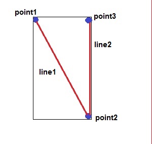

I don't wanna use the "mphselectbox" or "mphselectcoords" because of this problem; according to the image that I've attached Imagine in 2D, you have two lines and 3 points and you create a box using "mphselectbox" and the coordinates of the "point1" and "point2" *to get the entity number of "line1". (actually,the entity number of “line1” is our goal) as you see in this image, the result of "mphselectbox" function is the entity number of "line1" and also "line2" !!!!!!!!!!!! because "poitn3" is in this box (which is the smallest box contains "point1" and "point2")
