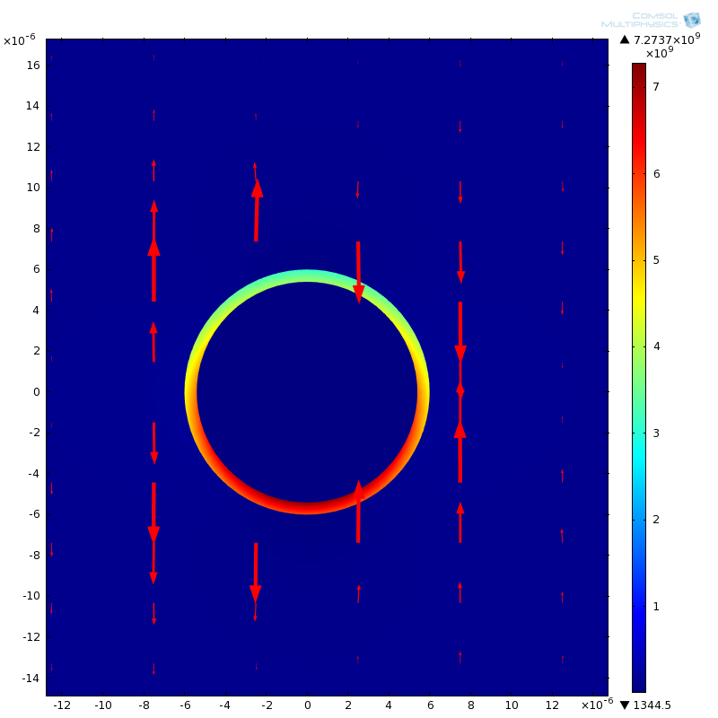

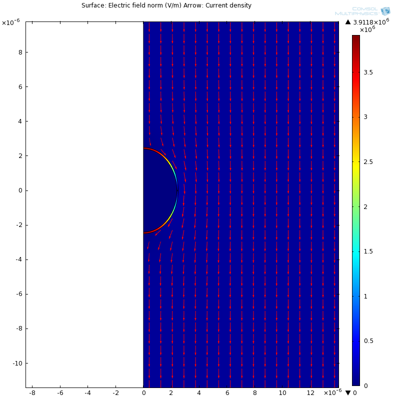

Hi Ivar,
Thank you very much for your quick response, sorry not answer before I had left home.
You were right, the conductivity of extracellular medium was badly defined, is 1.5 [S / m] approx, the membrane can be approximated by 1e-7 [S / m] and inside the cell 0.6 [S / m ]. Following your instructions I removed the aluminum plates, yet I think the result is not correct.
What I get is about opposing electric field lines (attached pictures). Actually, I don't know what I am doing wrong, I have done a simulation with the same parameters in axial symmetry and the result was correct (attached photo). Do you have any idea about why this happens?
Would I like to ask you a question axial symmetry axis can rotate, 45 degrees for example?
Is it possible to represent the angle theta with a special command or need to calculate the atan?
Thank in advance,
Michael.

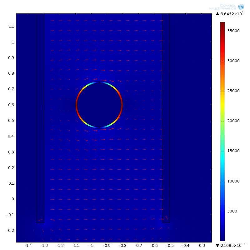

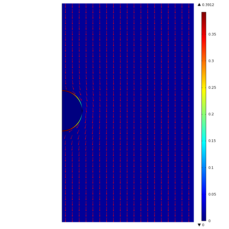

Thanks Ivar,
Your answer has been helpful to me, now I managed to correctly represent the electric field is now symmetrical as I expected. But the current density is not as uniform as in the case of axial symmetry. I attached the picture that I get if I use a slice instead of a 2D surface. When, I represent 2D surface I get a result that seems to be wrong.
I am attaching the photo of the axial symmetry with axis labels and the model. Could you tell me please if I´m doing something wrong in the model? I think that the main problem is with the 3D post processing, I´m relative new user in Comsol only 4 month and I had never used the 3D model in Comsol, all I have been done had been models in 2D axial or 2D now, I am trying to jump to 3D model. I really appreciate your help
Michael.

I rather suspect that your mesh is not the same in the two cases, try to plot the variable "h" in 2D-axi and 3D cut plane, or add in the superposition of the mesh grid on your cut plane view.
Often one need a very fine mesh which translates to huge models in 3D
