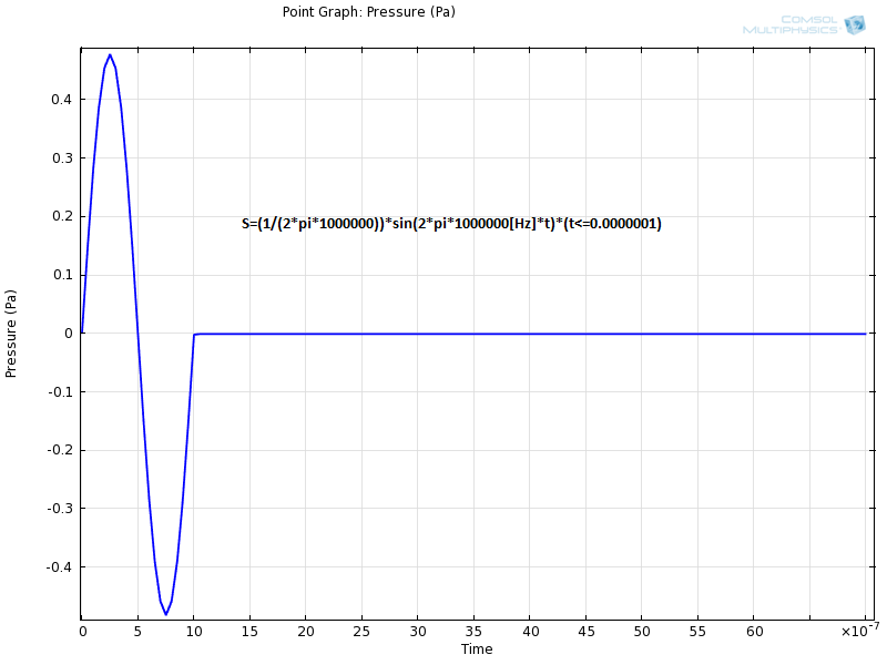

When i define S=(1/(2*pi*1000000))*sin(2*pi*1000000[Hz]*t)*(t<=0.0000001) i should be getting
a cosine pulse when 0<t<0.000001 and zero otherwise. But it gives me a sine pulse of magnitude
0.5 as shown in Fig 1.

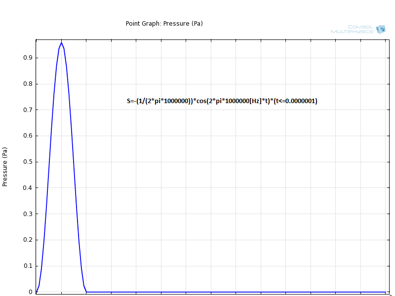

The second strange result that i observed was when i used S=-(1/(2*pi*1000000))*cos(2*pi*1000000[Hz]*t)*(t<=0.0000001) i should be getting a sine pulse when 0<t<0.0000001 and zero otherwise. But it gives me a srange result as shown in Fig 2.
