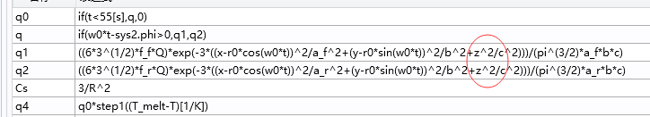

How to realize the double ellipsoid heat source offset left and right along the Z axis
Posted 24.11.2020, 04:16 GMT-5 Structural Mechanics Version 5.4 0 Replies
My double ellipsoid heat source can move in the ring direction, but it cannot be offset in the axial direction. I change Z+ or-a certain value, but it can’t be achieved. Can anyone help me see it? Thank you very much.
