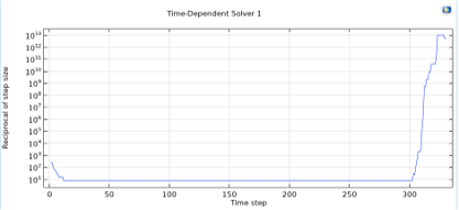

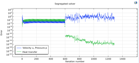

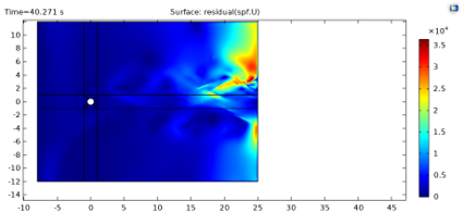

Up to around 100000 elements the convergence is good but for finer meshes the error of the segregated solvers shows a fluctuating error after a time of around 40 seconds. The residuals also increase significantly in this period of time. These plots can be found in the attachment. Furthermore, after the error appears ''May have reached a singularity. Time: 40.593993119146752 s.Last time step is not converged.'' A plot containing undefined values of the variable comp1.T appears and is also included in the attachment. Just before the simulation quits the timestep also decreases significantly. The reciprocal of the time step plot is included in the attachment.
