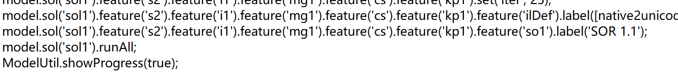

Hello All, I am runnign COMSOL with Matlab. The progress window does not show up. I am using 'ModelUtil.showProgress(true)'. Any comments on this?

Hi Asal, You can put 'ModelUtil.showProgress(true)' after 'run all'. The progress window will show up. Regards, Liu
