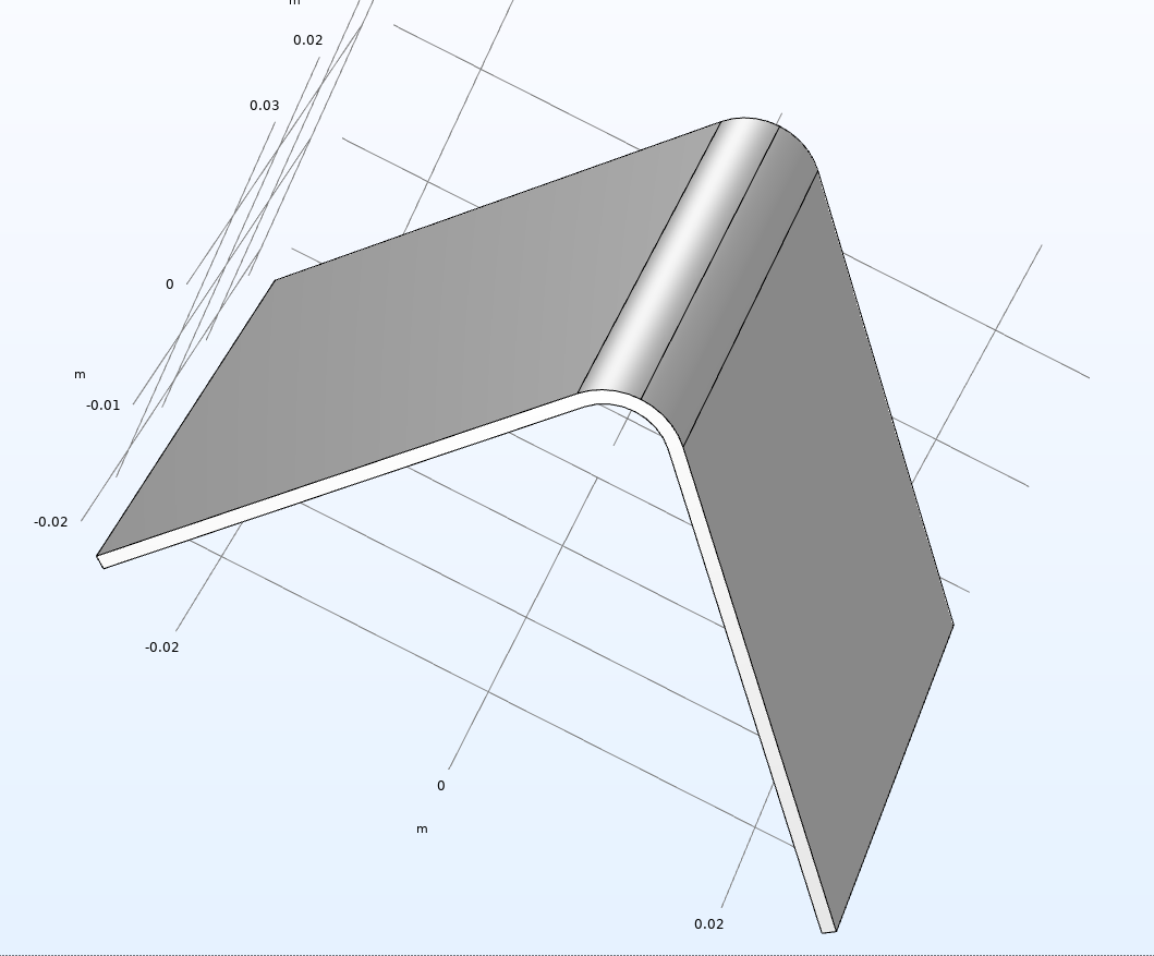

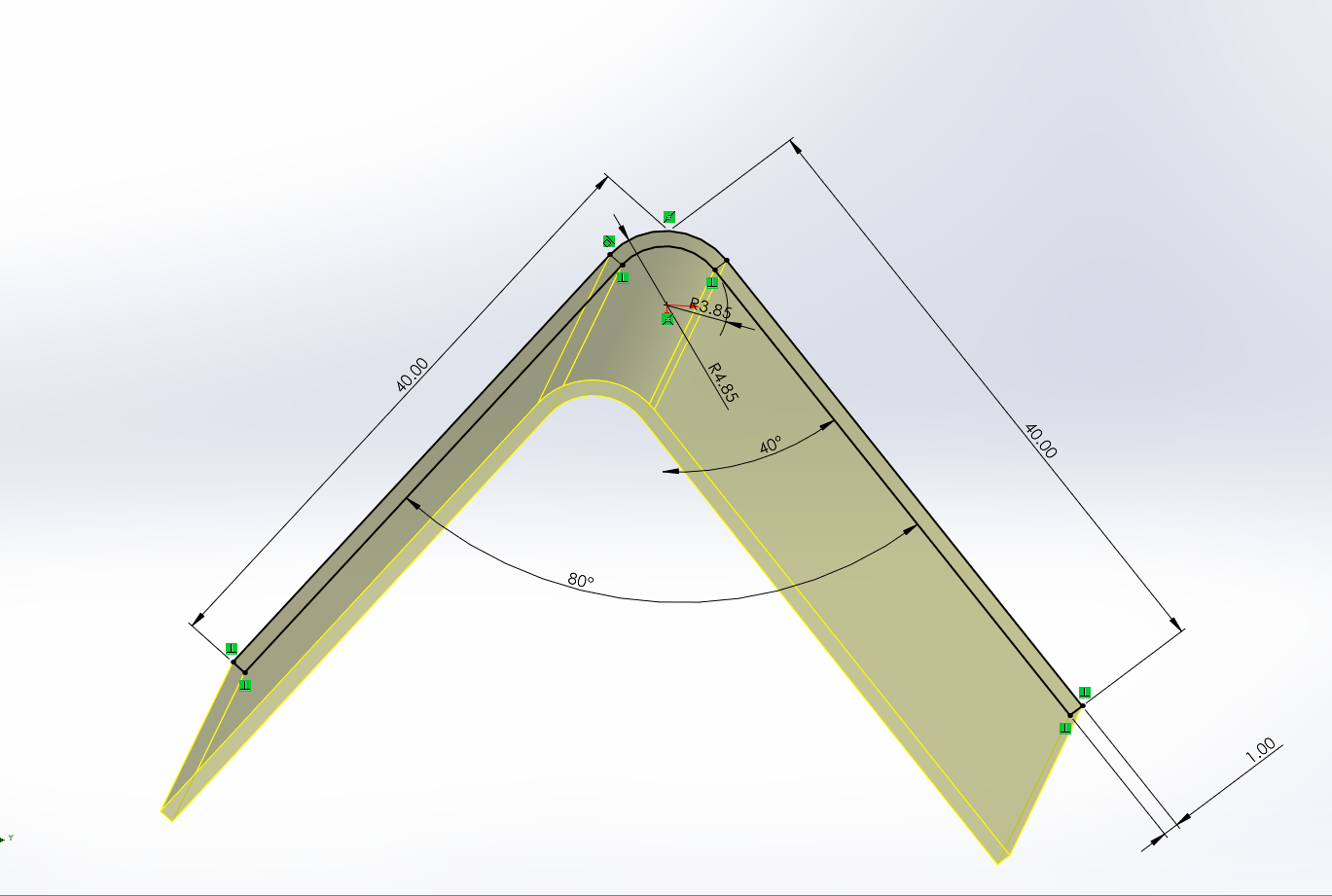

I'm currently using Solidworks 2022-23 for my CAD modelling. As you can see in the pictures below, there is no edges on the top when I sketch the shape in solidworks. But an edge emerged on the top of the shape when import the CAD file to COMSOL.
Does anyone has a solution to this? I've tried to import STEP file rather than SLDPRT file, but the issue still exsit.
