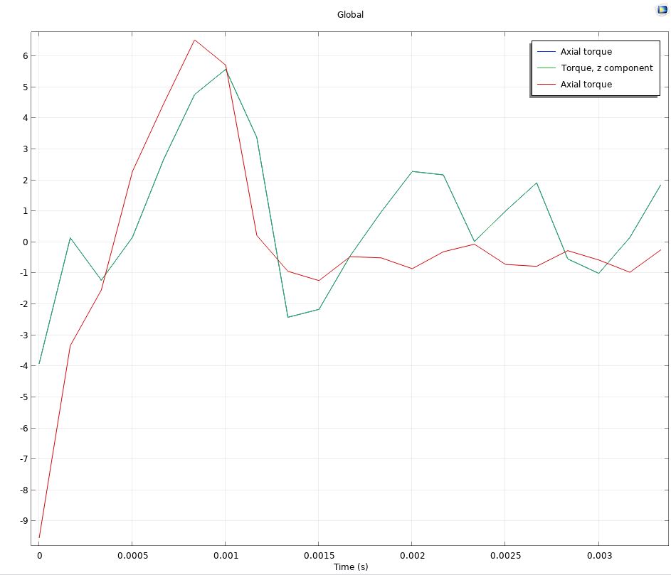

I am currently modelling a 3-phase PMSM motor in 2D in comsol. It is an outer rotor, inner stator design and everything seems to be working as expected except for the torque calculation.
Due to the motor being part of a project with an NDA agreement I can unfortunately not upload my model but I will try to explain the things I find weird with the torque results as best I can.
I am using both the Arkkio torque method and the normal force calculation. Both result in weird, and wildly different, results. The thing that bothers me the most is that I am getting non-zero torque for both torque calculation methods while supplying zero current to the coils.
The attached image is of the torque when supplying no current to the coils and rotating the rotor with 3000 rpm through a rotating mesh. The green line is the torque from the force calculation and the red line is from Arkkio.
The force calculation is defined over the domain of the rotor and half of the airgap (closest to the rotor.
The Arkkio torque domains are both halfs of the airgap, separated with a boundary pair with continuity.
Another weird effect of the torque is that the conductivity of the stator core has a big impact on it. Lowering the conductivity lowers the torque. If I choose a conductivity that is about two powers lower than the actual conductivity the torque becomes almost zero for zero current.
The entire mesh is extremely fine and with a boundary layer.
