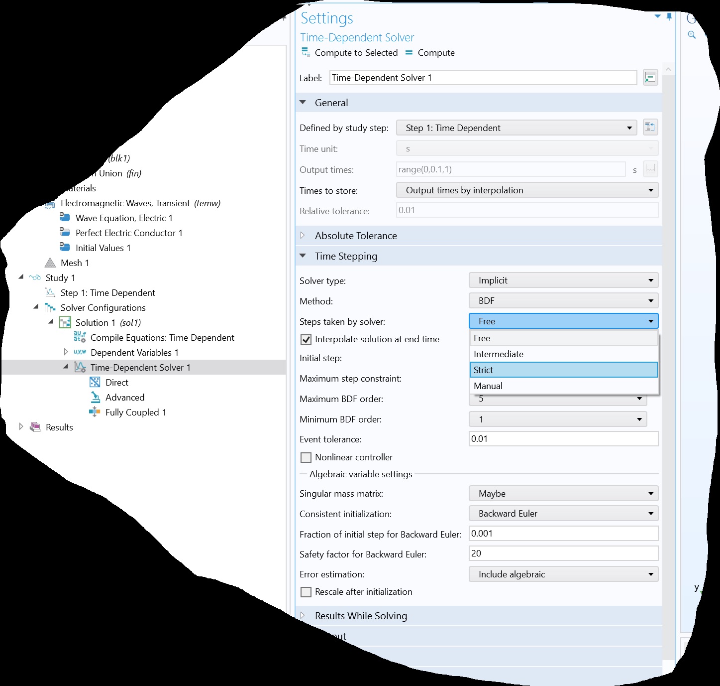

Thank you.But I do not konw how to choose the "manual" option for my time stepping, and Where to choose strict?
>You should be able to specify the time steps in sequential sequences, doing the first 10 microseconds in (for example) steps of 0.1 microseconds, followed by 10 seconds in 0.1 second steps (for example). The details of how well this will work likely depend on the details of your model. But I know that I have created models that start with short time steps and later switch to longer time steps. (Note that you will almost certainly have to set the time steps manually, rather than let Comsol try to figure them out for you.) I suggest you choose the "manual" option for your time stepping, although I suppose that "strict" *might* also work. Thank you.But I do not konw how to choose the "manual" option for my time stepping, and Where to choose strict?

I've attached a picture. This example is unrelated to fluid dynamics, so do not assume any other settings shown apply in your case. Anyway, I encourage you to study Comsol's provided application examples and familiarize yourself with the best settings for various time-domain problems of relevance to you.
