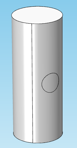

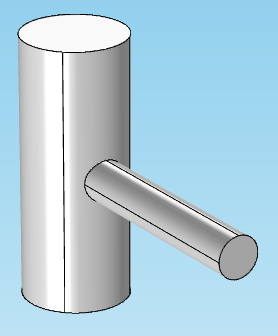

I don't have v3.5 so I'm not sure if you can do this or not, but here's how I'd do it in v4.3a:
Add the 1st cylinder
Add a 2nd cylinder perpendicular to the 1st that intersects the 1st where you want the circle to be
Use Conversions>Convert to Solid and add both cylinders to the selection list. This will generate the imprint on the face of the 1st cylinder where these cylinders intersect
Add a Delete entities node and delete the 2nd cylinder which you don't need any more.
See attached screenshots for the idea.
This should work for you.

Okay, I figured it out. Make the 2 cylinders, select both, press 'coerce to solid' then 'split object'. From there you have 3 objects, cylinder1, cylinder2 in cyl1 and cyl2 out of cyl1. Click the cyl2 out of cyl1 and delete it. Then select the two remaining objects, and 'coerce to solid' again. Then press 'Delete interior boundaries' to get rid of the boundaries left from the 2nd cylinder.
