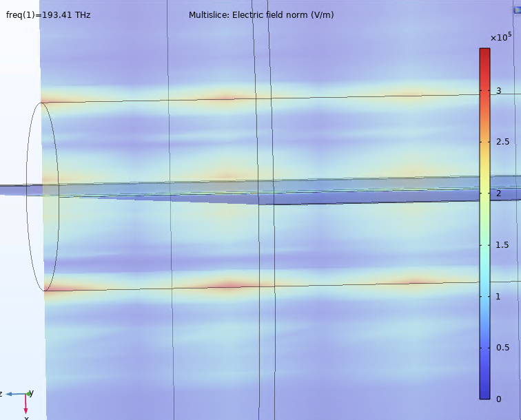

I am trying to run a 3D simulation and analysis using COMSOL 6.3 version, for a SMF. My geometry simulates a real fiber with 10 um core radius and 125 um cladding radius. The idea was to simply see propagation through a short lenght on lam=1550 nm.

For my surprise, the propagation seen in my study was quite different from the original, and not commonly seen on theory. The electric field is pulsing during propagation length, with little concentration on the core and significant in the interface between core and clad.
If someone could please help me understand what I am doing wrong, I would appreciate. I´ve ran 2D simulations in the past, but I´m rookie on 3D.
