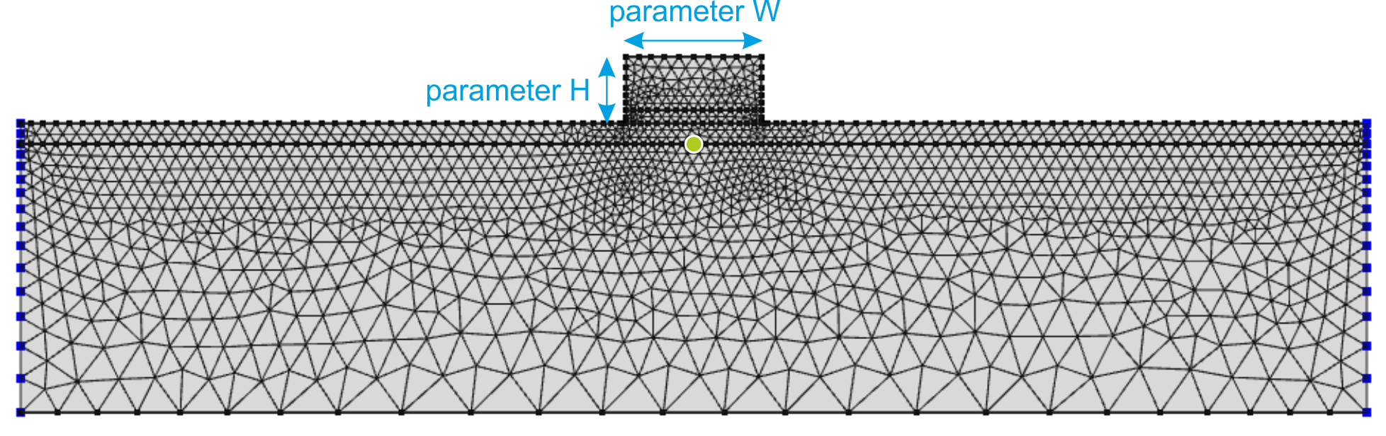

Well, I'm interested in a model as attached. I'm using the Structural Mechanics Module in order to calculate a deformation at low temperature caused by different thermal expansion coefficients. Therefore I have two parameters to play with: the width of the top metallization and its height. But, I'm just interested in stress calculations (solid.sy, solid.sxy) relating to the centered point X shown in the attached figure as well (green). I set the point already in the model to make it selectable after the calculations.
My problem is, that the calculation will calculate everything and the calculation time will increase extremely (1s for one pair of parameters at the beginning and up to more than one minute at the end) due to the fact, that the whole solution for every pair of parameters and for the whole mesh is buffered in the memory. Concerning that matter the server will crash in most cases at 80 or 90 % of calculation.

OK, I want to give a solution by myself for everyone who has the same problem.
I found the possibility to define probes (for boundaries and also points), where you can setup the coordinates and the expression which you want to calculate - exactly the thing I was looking for. Then you activate the option "only last" for "Keep solutions in memory" inside of "Parameter sweep". Now, calculation won't freeze and the calculated expressions (sxy, sy, ...) for the sweeping parameters will be added into a table while the calculation.
