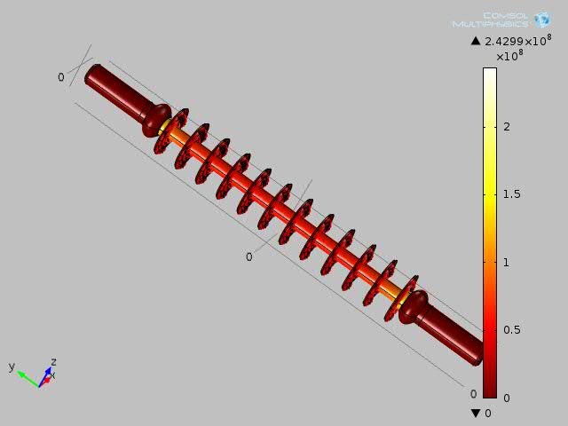

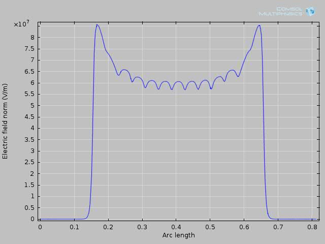

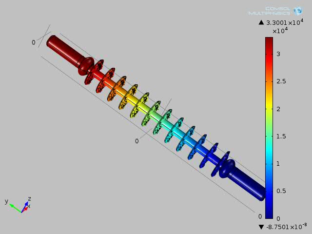

I apply 33Kv voltage at HV end. I got result, in this result potential along the insulator surface is linear distribution, but not uniform field distribution along the surface and also field at HV (33KV) terminal as same as ground terminal, why sir ?
i attach my model image.
Thank u sir

I would expect a higher field close to the terminals and the geometry is the same on both ends.

In HV end : field is high bcoz 33Kv applied, but same field will occur in ground end (zero potential), why sir?

Sure, your geometry is symmetric. It doesn't matter where HV and ground are connected.
But looking at your pictures, I think you are making a very basic mistake. You don't have an air volume around your device. So you confine the model into the interior of the device. That is probably not what you want.
Another hint: The device has axial symmetry. You can save tremendous memory and computing time by setting up this in 2Daxial geometry. And the precision of the results can be much better.
