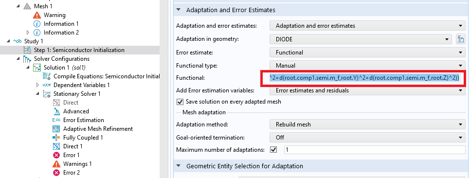

I was trying to use the Adaptation and Error Estimates functionality. In the Functional field, I entered:
root.comp1.semi.intadapt(sqrt(d(root.comp1.semi.mf,root.X)^2 + d(root.comp1.semi.mf,root.Y)^2 + d(root.comp1.semi.mf,root.Z)^2))
Then I changed it to:
root.comp1.semi.intadapt(sqrt(d(root.comp1.semi.mf,root.X)^2 + d(root.comp1.semi.mf,root.Y)^2 + d(root.comp1.semi.mf,root.Z)^2 + epssmall))
to avoid division by zero. However, whenever I run the computation, the parameter** eps_small** is automatically removed from the expression, even if I try to save it. Could you please help me understand why this happens and how to keep the parameter in the expression?
Thanks a lot for your help.
