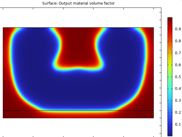

I'm working on a 2D topology optimization for a natural convection heat sink in COMSOL using the SIMP method and MMA solver, but I've run into some issues and would appreciate your advice.
Model setup is as follows:
Domain: A non-design base block at the bottom and a topology optimization (TO) domain on top.
A constant temperature is placed in the middle of the bottom boundary.
Steady-state heat transfer.
Natural convection on the outer boundaries (constant heat transfer coefficient, h).
The reduced-order material conductivity for (TO) domain:
k_simp = k_air+(k_solid-k_air)*dtopo1.theta^3 (psimp =3)
Expected result was a tree-like structure, but the simulated result looks a dis-continuous area (see attached image)
  1. How to get continuous material?
  2. How to get the tree-like structure?
