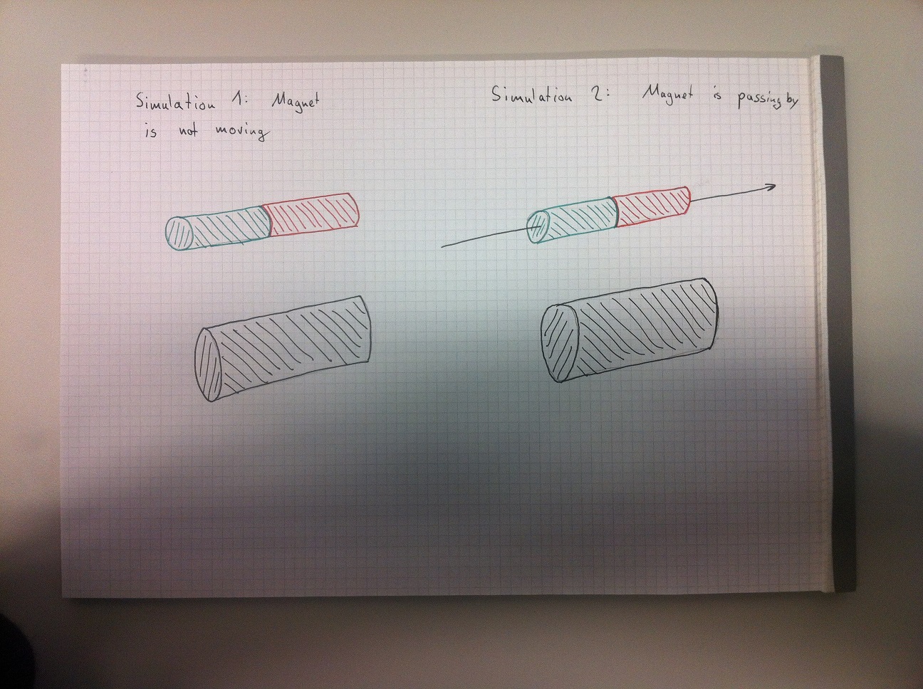

The simulation should analyse the following problem: A magnet is passing by a piece of iron. (sketch.jpg) As Study Step I chose Time Dependent.

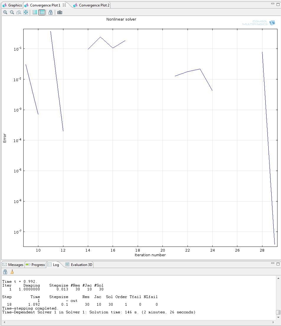

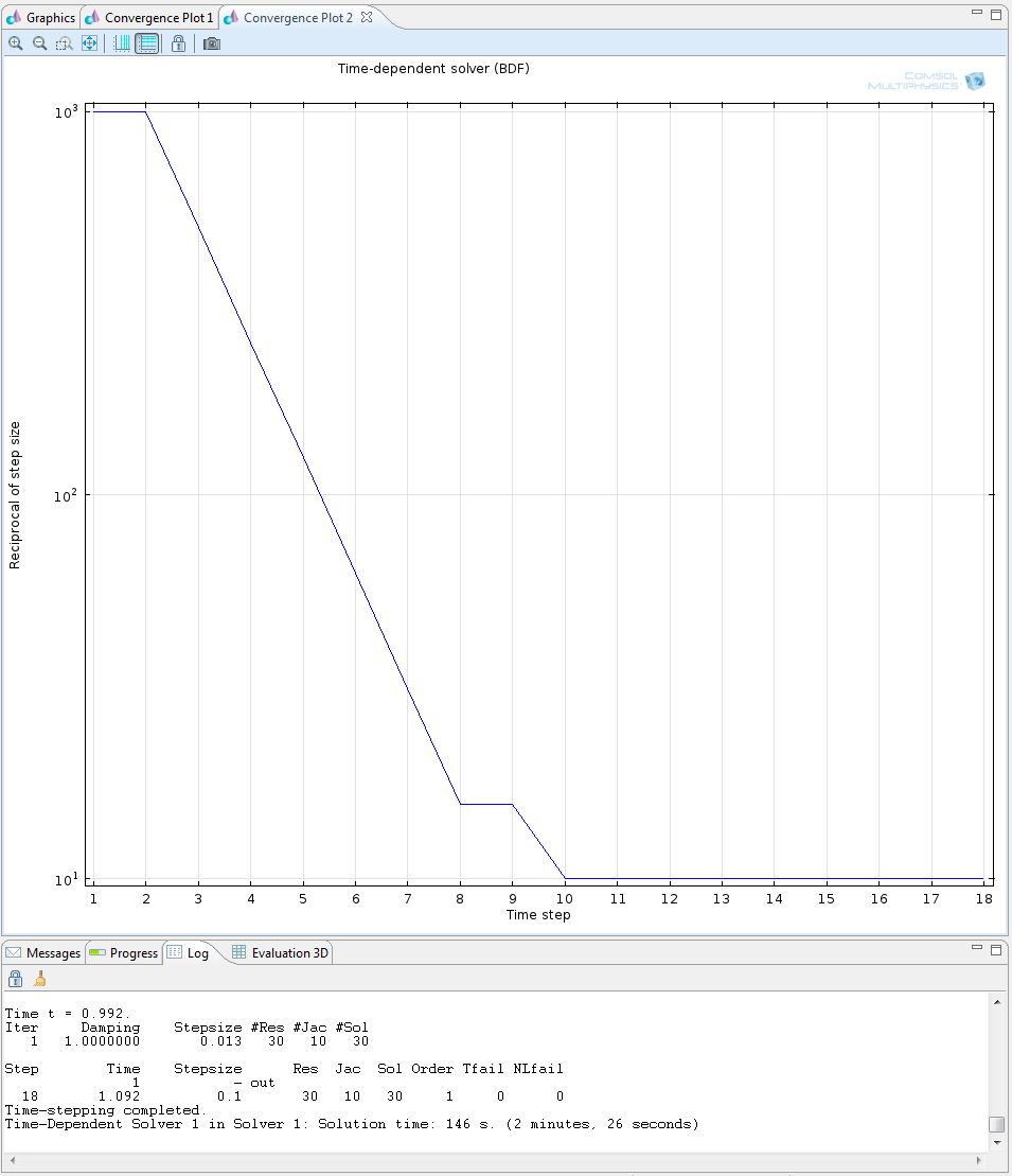

At first I tried a simple problem, where the magnet was not moved at all. The magnet is just slowly switched on and off by using a smoothed rectangle function. This simulation takes about 2 Minutes on my PC, the solutions are mostly converging very well and the time steps are rather large. (convergence weak field.jpg; step size weak field.jpg; graphics weak field.jpg)

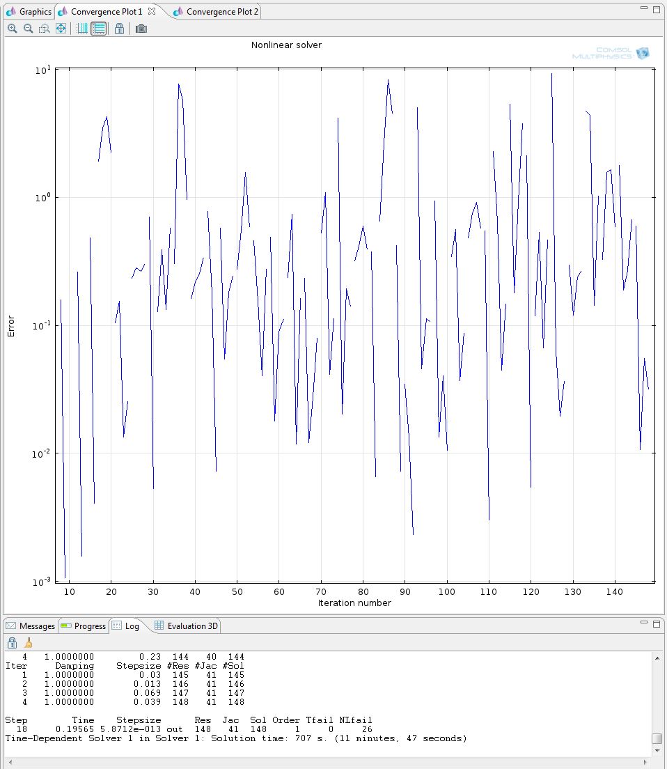

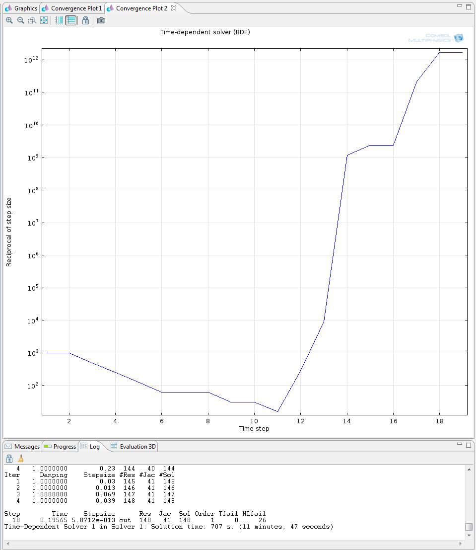

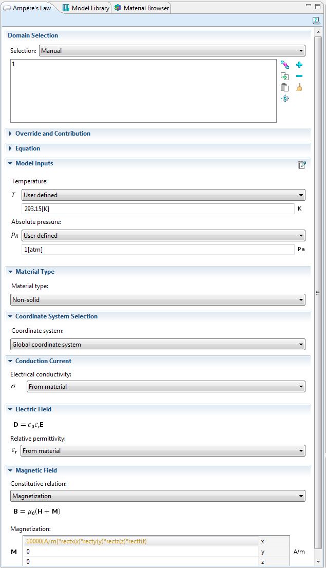

But if I increase the strength of the magnet by a factor of 10 (magnetization.jpg; 1000 A/m works, 10000 A/m does not), without changing anything else, convergence gets worse and time steps get very small until the simulation ends with an error after 20% of the time. (convergence strong field.jpg; step size strong field.jpg)

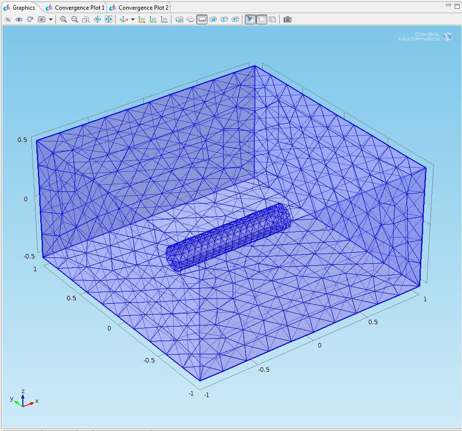

I searched for this error in the forum and could not find the mistake in my model. The mesh looks good (mesh.jpg), the magnetization is smoothed both in time and space, there are no sudden changes in the magnetization, there are no sharp start conditions.

looking at your model it is striking that the magnetization function that you prescribe is not resolved well - neither in space nor time. Have a look at the attached animation.
The mesh inside your domain is much coarser than the step function. Yo are trying to define resolve a sharp heaviside-like function with a smoothness of 0.05/3 with a mesh that has an h of 0.15-0.2, which is afcator of 10 coarser.
Likewise you do not constarin the time-steps, but leave the solver time stepping "free". This means that the solver might miss the sharp ramp time at the tail of your signal.
Recommendations:
- Rather *draw* a domain (block) that defining a space dependent function. This ensures that your mesh is located on the boundary of your magnetisation discontinuity.
- even if you want to move your object in time this may be the better solution. Think over, if you really want to have a time-dependent study in the end or if not a sequence of quast-static steps is rather appropriate. In such a case you could use the stationary solver with a parametric sweep to move your object.

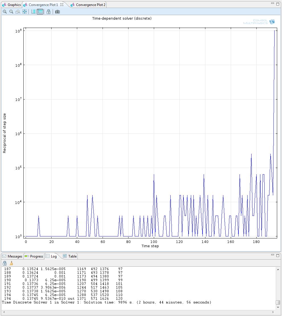

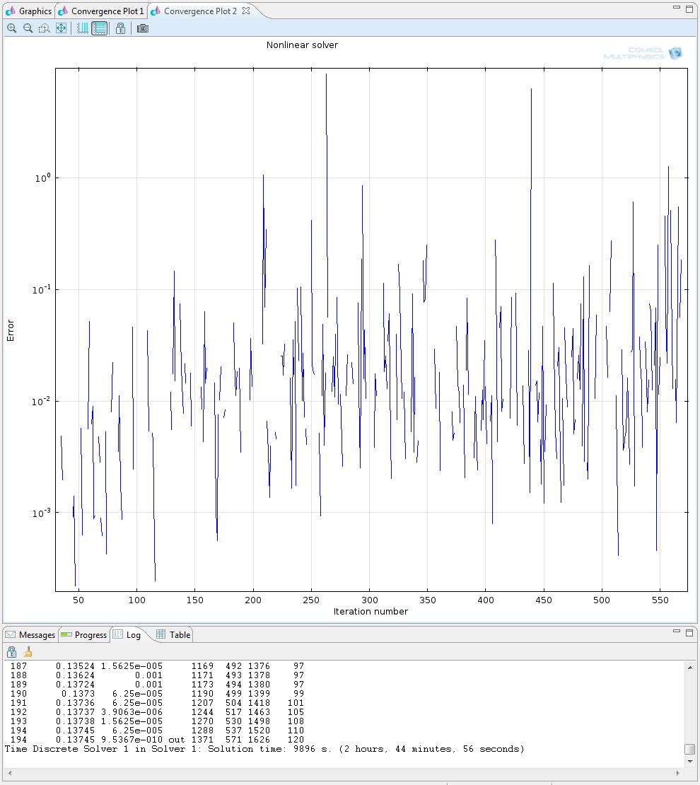

This more precise hysteresis model seems to make convergence very difficult. I have to take a very small step size and even than convergence problems may occur. It will take hours of computing time only to power the magnet up. (Remanenz 3.mph; error.jpg; step size.jpg)
Any Ideas to speed things up?
