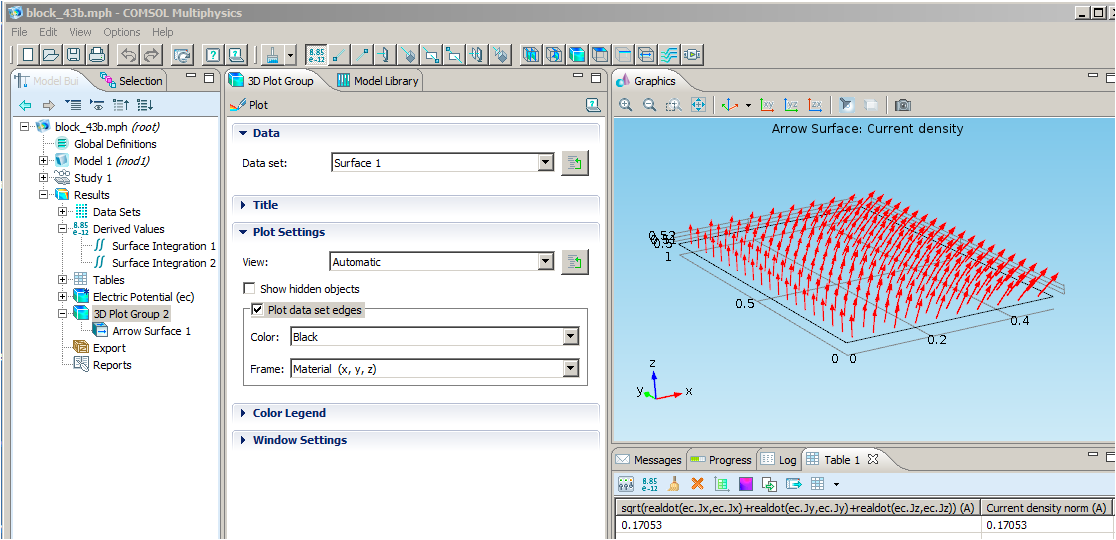

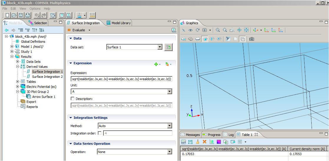

Evgeni,
Not sure why you are getting the error message but attached is your model file with evaluated integral of the normal current density over internal surface.
Both methods of the surface integration of
sqrt(realdot(ec.Jx,ec.Jx)+realdot(ec.Jy,ec.Jy)+realdot(ec.Jz,ec.Jz)) and ec.normJ
work fine and give the same result.
Sergei

Actually, on nth thought, we shouldn't need to go through the hassle of defining a complementary physics interface or dealing with assembly pairs just to find the current through a boundary.
So I've tried integrating
realdot(sys1.e_n1, ec.Jx) + realdot(sys1.e_n2, ec.Jy) + realdot(sys1.e_n3, ec.Jz)
over an internal boundary, and it worked! (Checked against the method with the two Electric Currents interfaces that I've written about above.)
So my criticism with Comsol in this regard is: why not define nJ as the above expression on internal boundaries? Integrating flux over internal boundaries might be a common-enough requirement, and nJ isn't defined on them anyway. (While the nJ of the Boundary Current Source should be named something else, of course.)
Note that, to the best of my understanding, to get accurate fluxes with reacf on internal boundaries, one still has to use one of the methods described in my previous post.
