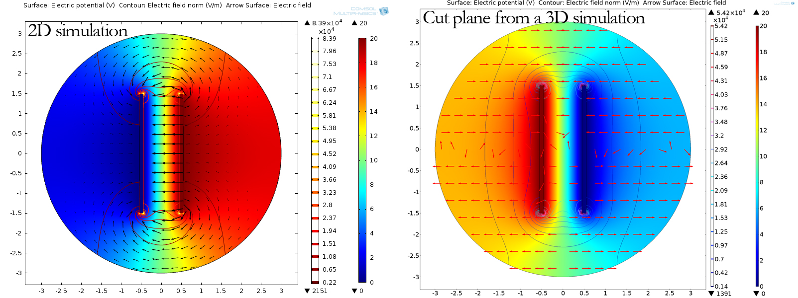

I'm a beginner COMSOL user. I came across this problem while i'm doing some test simulations. I've simulated a parallel plate capacitor in both 3D and 2D. I wanted to see if I can extract the same results from the 3D if I use a cut plane. So I created a cut plane so the resultant would be similar to a 2D situation. However when I extract the electric field directions, they do not look even remotely close to the results from 2D simualtion. I've attached two images from two simulations. I'm using "Electrostatic (es)" in both cases and all the materials are same in both cases. I would be very grateful if anyone can point out what I'm doing wrong.

Thank you for your reply Edgar. Original file size was about 50MB and it did not change even I deleted the solution and mesh. Therefore I created another file similar to the original file. Please find it attached(3MB).
All I did was simulated the model and created a 2D plot with a potential surface and a arrow surface representing the electric field. (I used a cut plane on the zx plane.)

I modified your model according to your description, looks ok to my taste. You didn't send your model so I can't say what is wrong there.

Check whether in the arrrow plot in your 3D cut plane you are plotting the _in-plane_ components of the E field. I suspect you are not.
PS: Usually, with simulations like these, you do not include the electrodes in the model: they are considered perfectly conducting and you know in advance that the potential is going to be constant in each of them, so you remove them from the geometry and only solve for the potential in the dielectric (i.e. you subtract the two blocks from the sphere). As a result you only need air as a material (no copper).

Thank You for your responses. Jeff you were spot on. My plane was a xz plane and I was plotting x and y components on the plane(beginner mistake). Now that I corrected it, it looks the way it should be. That was a great tip to subtract the blocks from the sphere.
