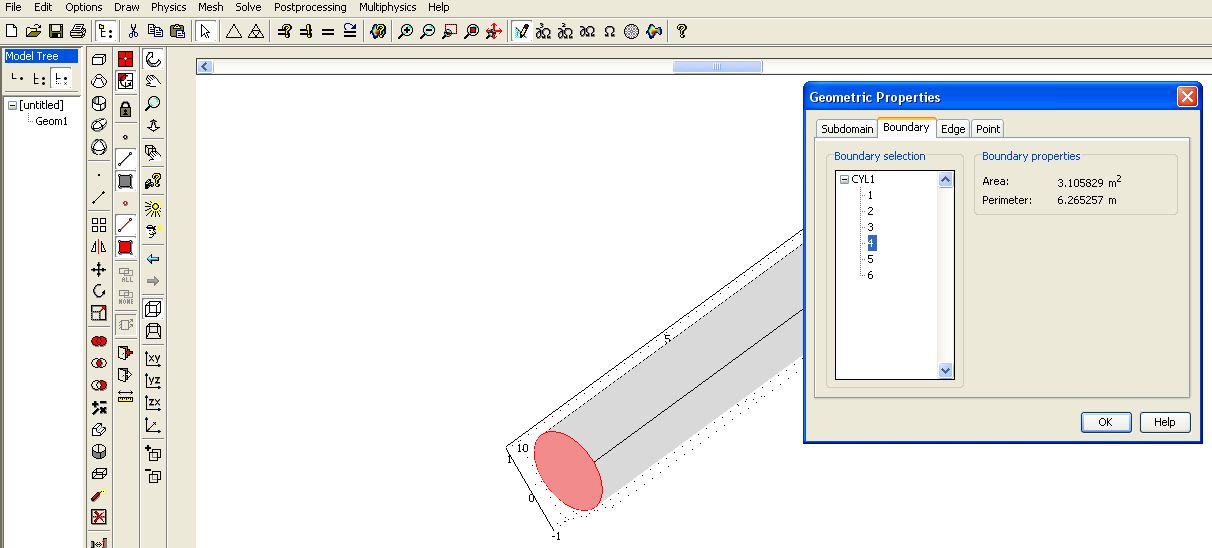

Oh i forgot one more thing
1. if we draw a cylinder with unit radius(R=1) and if we want to see the face area it should be (Pi*R^2)
i.e (Pi*1^2) = value of Pi = ~3.1415926535897932384626433832795
but in comsol it shows ~3.105829 why??? so much error and how to minimize it???
