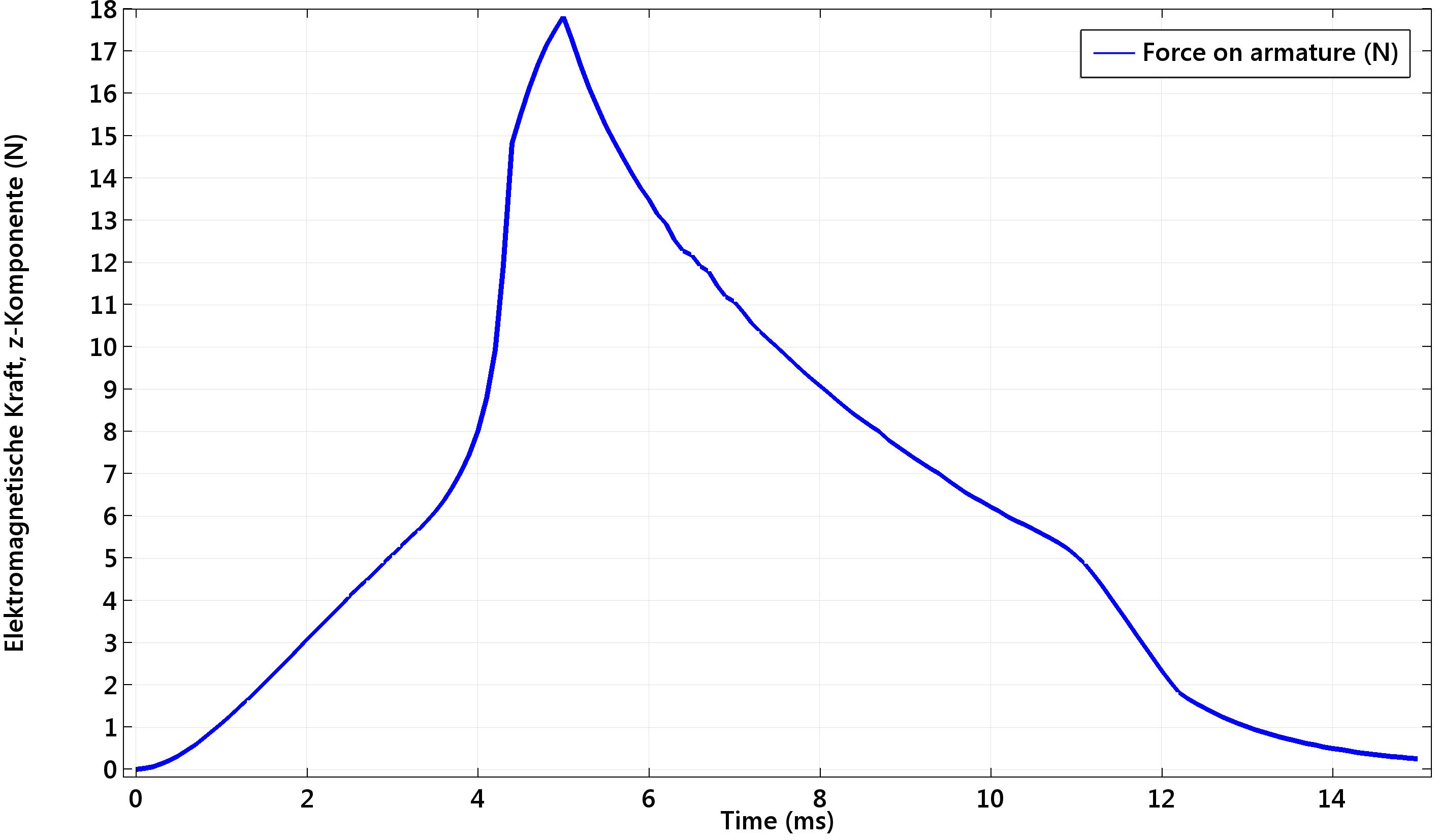

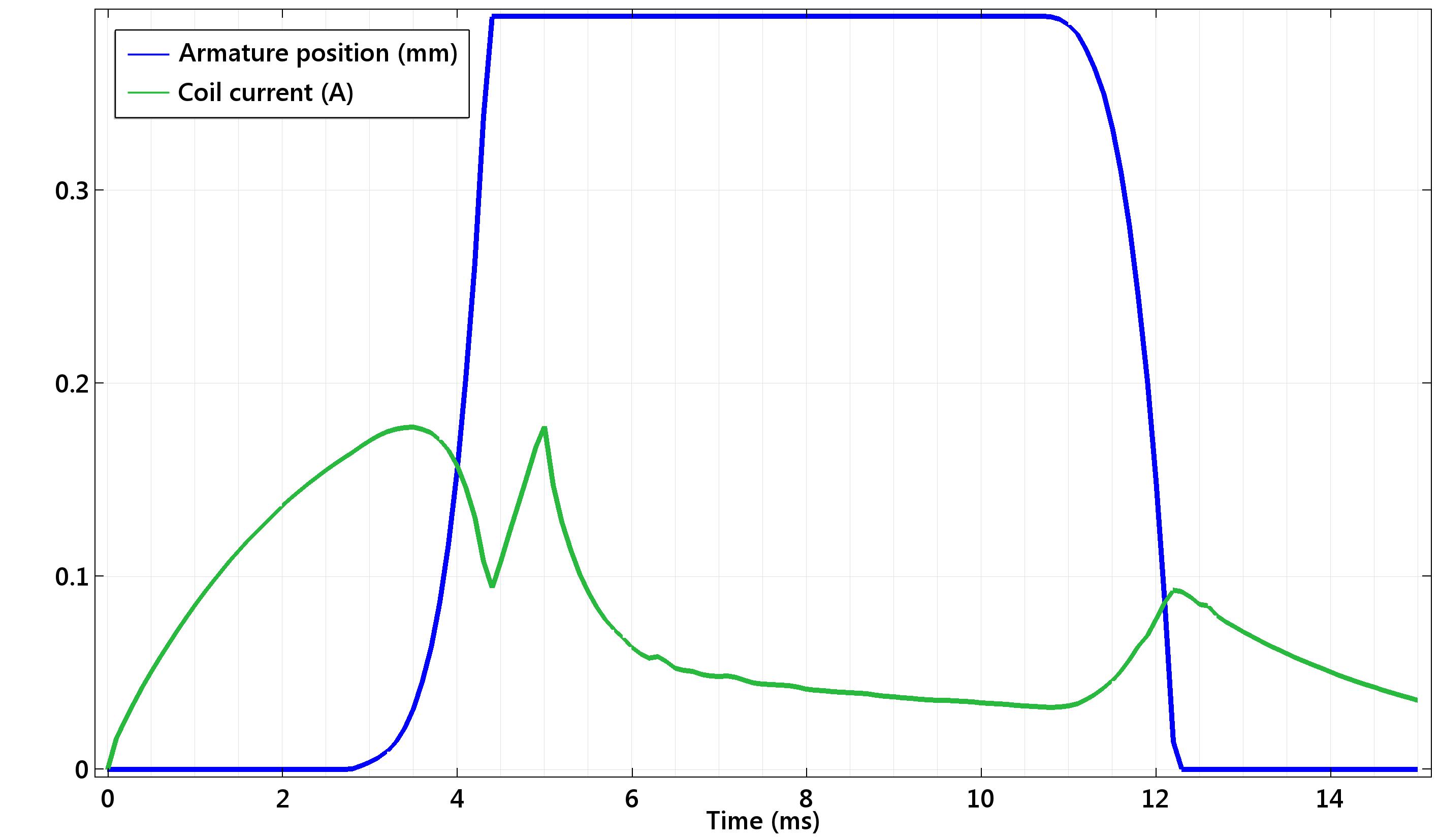

attached is a model of a switching solenoid.
The switch on time is good and meets my expectations. The Switch off time is very slow. I think this is not correct. What can be the reason for this behaviour?
