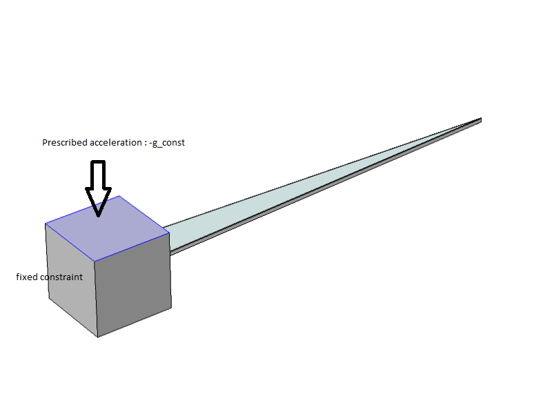

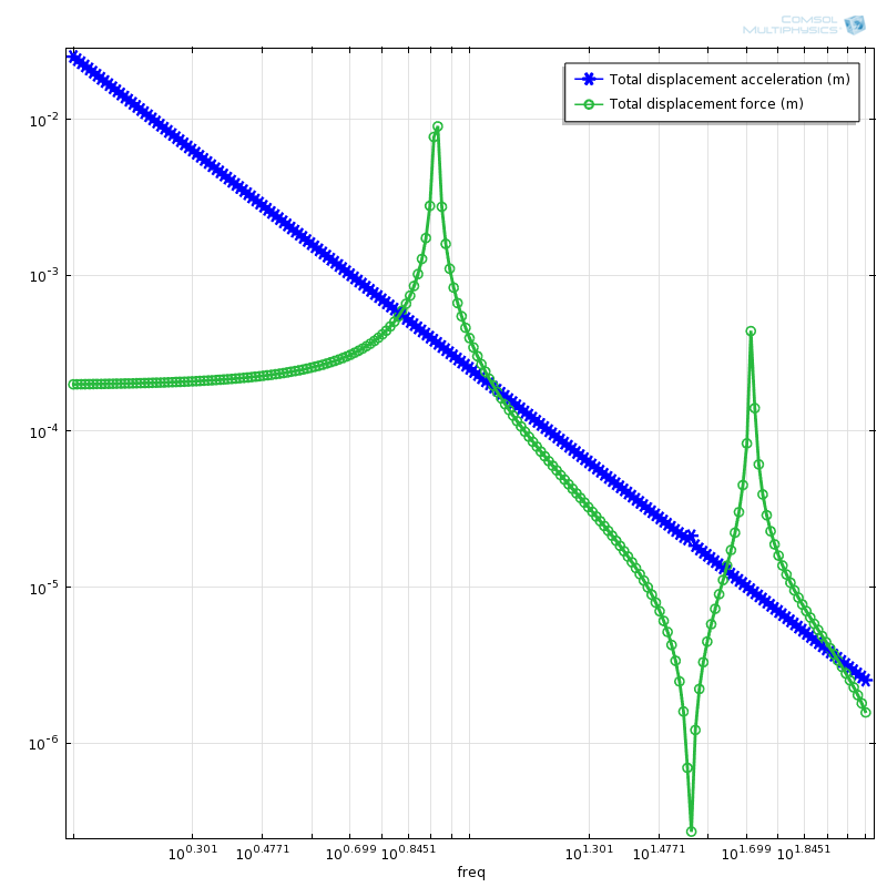

But now, to come back to the MEMS shaker test:
If you apply a shaker test (on a beam just to have an example) you have basically (at least) 2 possibilities:
1) you place the full system on the shaker and you apply a body load from the acceleration of the shaker (your fixed point is also shaking ! hence this is not "just" using the acceleration boundary or domain body load on a fixed lever
2) you attach a boundary to the shaker and you apply locally an excitation force, but the fix point is "fixed" inertially
the responses are different see below.
Take a beam 1, 0.1, 0.01 m^3 (x,y,z) size in structural steel. Attach "fixed" boundary 1 (the first small 0.1x0.01m^2 or y,z plane side), load boundary 6 (the other end of the beam) with an acceleration and then with a Force (both in Z), and do a harmonic scan of the type f=10^{range(0,0.01,2)}
then plot in log/log (or adapt to dB) mode the average "w" or "disp" value of the excited boundary "6" you will not get the same response.
Then, try a domain acceleration => its all wrong so long you do not replace the "fixed" boundary condition by something adapted to the acceleration motion,
something to think over ;)
That is why using COMSOL is fun, you can test quickly on simple examples without braking anything

if you impose an acceleration or a prescribed displacement the response is fixed your harmonic displacement is given or driven via acc=iomega^2*disp
Tryo use a boundary force of 1[N] then you will see the bodeplot if you plot the average tip displacement versus frequency (see my previous graph image above)
Hi if you impose an acceleration or a prescribed displacement the response is fixed your harmonic displacement is given or driven via acc=iomega^2*disp Tryo use a boundary force of 1[N] then you will see the bodeplot if you plot the average tip displacement versus frequency (see my previous graph image above) -- Good luck Ivar

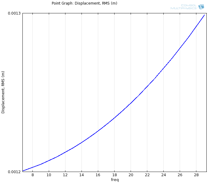

Hello everyone,
I've got a similar problem with a simulation of a vibration test. For easy understanding and a fast simulation I have simplified the model to a beam with the dimensions 1m * 0,02m * 0,02m (x, y ,z), which is fixed on the left end. Now this cantilever should be excited by an acceleration, but I don't know how to define this acceleration in the simulation. The first try was to define a boundary "prescribed acceleration" at the fixed end of this beam, but then the first condition gets overwritten, which is definitely wrong. I've also tried to simulate the beam of Ivar and the same results came out, but this is not the same task. I need a frequency-acceleration plot of this model, where the acceleration amplitudes of this cantilever can clearly be seen due to the eigenfrequencies of it. For example (acceleration of 5 m/s²), for the first 10 Hz there is almost a constant acceleration of 5 m/s², but at the first eigenfrequency of about 16 Hz there is a gain of xxx Q. After that the acceleration goes down and gets higher again at the second eigenfrequency, and so on.
So, how can I simulate this task, where should the acceleration act and also which kind of acceleration should act?
Thank you in advance for your help!!

Hi Ivar,
thank you very much for your answer. I've tried to use a body load and have a question about the simulation results. The acceleration peaks are not realistic, aren't they? And how do I get realistic stress results? If I choose von Mises stress at the eigenfrequencies the stress is much too high. The results are important, because with these values it is possible to choose the right material and/or geometry. The same thing happens if I choose a geometry of 1*0,2*0,2m, where the maximum acceleration is about 1400g...
Another question to your answer, how can I apply a harmonic body load and where can I find the frequency harmonic solver? If I right-click on body load and choose "Harmonic Perturbation" it should be harmonic, but if the simulation gets computed the acceleration is really small (about 1e-4). Do I have to set something else? Or do I have to choose the "Frequency-Domain Modal" Analyses? Because there I get some results, which aren't too low or high...
Last question, how is it possible to generate a PSD curve? I think this is just possible in the time-dependent analyses, isn't it?
Thank you very much for your help!!!!
PS: You can find a acceleration over frequency plot in the attachment of the cantilever example (1*0,02*0,02m) with 5 m/s² body load (steel). Are the results right?

I'm not by my WS so I cannot test it out, but why shouldt the amplitudes be correct ? If you apply a body load of g_const*solid.rho its gravity load, and this has always worked for me ;)
What you might see is the Q facor amplification, when you excite the resonance, have you added some damping in your system ? to make it more ralistic ?
Normally, the stress is related to the displacement, so if the displacement is not realistic, certainly the stress is neither not correct.
Have you found the frequency domain solver, check the equation view to see what you can do and what is considered.
One can transfor a PSD to an equivalent frequency sinus sweep response (in LTI system) check the web on virations loads, our the litterature

Posted: 1 decade ago 20.04.2012, 07:40 MESZ
thank you very much for your fast answers! Ok, good to know. I just thought the amplitudes are too high, but at the moment no damping has been included in the simulations.
You said the stress is related to the displacement, which is clear. But I've seen some other comments and questions in this forum where you say, that Comsol just calculates the eigenfrequencies of the respective part and therefore the displacements are not really correct, they are normalized by an factor. In this case it's the same problem, I get deformations of about 4 meters, where the cantilever has just a length of 1m. Do you maybe know where it is possible to see realistic deformations and stress? Or where you can set this normalization factor to get realistic results?
At the frequency domain solver it is just possible to choose the available study type. What do you mean here?

Posted: 1 decade ago 20.04.2012, 17:49 MESZ
eigenfrequency analysis is normalised and amplitude are arbitrary (you can select three different types of normalisation in v4.2a also to give mass participation factors) see the solver sub node for eigenfrequency.
A frequency domain (harmonic development) is giving you "correct" amplitudes, if you have enough damping to have finite Q factors. The difficulty is really to decide what to use for the damping, as this is very model dependent, you have material damping, assemby damping and perhaps also eddy current damping, induced fluid flow damping ...
By default there is no damping (apart perhaps something from numerical effects) there is a specific chapter in the reference doc, I believe on that too

and to add a little more, the prescribed acceleration on a "otherwise fixed" base, works OK with the Frequency Domain solver, but I cannot get it to work with Frequency Domain Modal solver, as I havnt found out yet how to apply a harmonic perturbation on the "acceleration".
And I want to correct my too quick remark earler hereabove, a distributed force load (or body load), and a prescribed acceleration are not look fully the same, as the transfer functions varies. For a prescribed base acceleration you need to analyse the difference between the point on the object and a reference point on the moving/accelerated "base"
A third method (at least present in 4.2a) that does work in Frequency Domain Modal is to apply a Force on teh otherwise rigid base, such as total_mass*g_const.
Note there is something else with the Frequency Domain - Modal studies refgarding the amplitudes. as there are two places where to define amplitudes (and damping), at the BCs and at the modal solver node
This needs some more testing before I can say I master it fully ;)
Hi and to add a little more, the prescribed acceleration on a "otherwise fixed" base, works OK with the Frequency Domain solver, but I cannot get it to work with Frequency Domain Modal solver, as I havnt found out yet how to apply a harmonic perturbation on the "acceleration". And I want to correct my too quick remark earler hereabove, a distributed force load (or body load), and a prescribed acceleration are not look fully the same, as the transfer functions varies. For a prescribed base acceleration you need to analyse the difference between the point on the object and a reference point on the moving/accelerated "base" A third method (at least present in 4.2a) that does work in Frequency Domain Modal is to apply a Force on teh otherwise rigid base, such as total_mass*g_const. Note there is something else with the Frequency Domain - Modal studies refgarding the amplitudes. as there are two places where to define amplitudes (and damping), at the BCs and at the modal solver node This needs some more testing before I can say I master it fully ;) -- Good luck Ivar

First how to simulate body loads with different materials ?
that is easy: as you define the load as a density in N/m^3 or simply g_const*solid.rho
This way you distribute the load on each mesh element depending on its local density (also valid for a density that might vary with the position in a domain). You can also say that you know the totoal mass, and acceleration F= Mass*g_const. Then COMSOL will distribute that AVERAGE force value onto each element, not exactly the same and certainly not for different domains with different densities
2nd point acceleration or body load ?.
I say that both work with a frequency domain sweep, but the prescribed acceleration does not work (for me, I might have missed something) for the frequency domain - modal analysis, as I cannot set the harmonic perturbation option on prescribed acceleration loads.
I was too quick in my first reply, and forgotten that a body force random excitation is not exactly the same as a random prescribed acceleration (from the base) excitation. The transfer functions differ, in one case its x, in the other case its (x-xbase) relative motion you are looking after.
But if you have a complex model Frequency domain might be heavy to solve, while frequency modal is rather quick and precise enough if you sort out the main modes
Hi First how to simulate body loads with different materials ? that is easy: as you define the load as a density in N/m^3 or simply g_const*solid.rho This way you distribute the load on each mesh element depending on its local density (also valid for a density that might vary with the position in a domain). You can also say that you know the totoal mass, and acceleration F= Mass*g_const. Then COMSOL will distribute that AVERAGE force value onto each element, not exactly the same and certainly not for different domains with different densities 2nd point acceleration or body load ?. I say that both work with a frequency domain sweep, but the prescribed acceleration does not work (for me, I might have missed something) for the frequency domain - modal analysis, as I cannot set the harmonic perturbation option on prescribed acceleration loads. I was too quick in my first reply, and forgotten that a body force random excitation is not exactly the same as a random prescribed acceleration (from the base) excitation. The transfer functions differ, in one case its x, in the other case its (x-xbase) relative motion you are looking after. But if you have a complex model Frequency domain might be heavy to solve, while frequency modal is rather quick and precise enough if you sort out the main modes -- Good luck Ivar

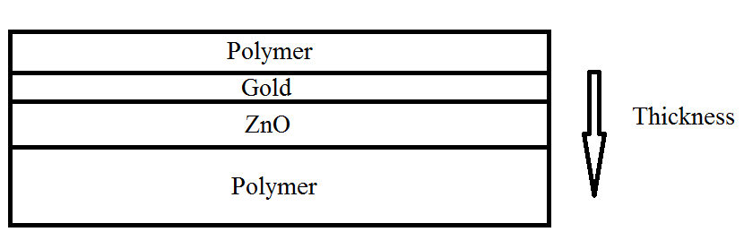

Ivar,
First let me thank your for your quick and detailed response. I have few questions regarding your suggestions,
1) I am a beginner with Comsol and I do not know what should be the GND, floating potential, terminal settings. I find the manual insufficient to make users understand these features. They do not have any solved examples on the website. I have searched through this blog to find out worked out models shared by other users but unfortunately there are very few and what is worse is that they are in Comsol 4.2. I would request you to share with us some model on "Piezoelectric accelerometers". This would help many other users who are beginners.
2) I have ZnO as piezoelectric material. Gold is used as an electrode. I can model it as a thin layer. But I can not fild 'thin layer' primitive under the geometry node. Is this something available in the newer versions? I have 4.1.
3) I have tried using 3 elements along the thickness of every element. The natural frequency and the mode shape is the same, but the software is still incapable of performing a frequency sweep.
4) The bottommost and the topmost layers are polymer, so they are not conductors. Frankly, I do not know what electrical connections need to be used for obtaining the voltage and charge generated in the piezolayer during frequency sweep.
I do not want to give up.
-Sankha
Ivar, First let me thank your for your quick and detailed response. I have few questions regarding your suggestions, 1) I am a beginner with Comsol and I do not know what should be the GND, floating potential, terminal settings. I find the manual insufficient to make users understand these features. They do not have any solved examples on the website. I have searched through this blog to find out worked out models shared by other users but unfortunately there are very few and what is worse is that they are in Comsol 4.2. I would request you to share with us some model on "Piezoelectric accelerometers". This would help many other users who are beginners. 2) I have ZnO as piezoelectric material. Gold is used as an electrode. I can model it as a thin layer. But I can not fild 'thin layer' primitive under the geometry node. Is this something available in the newer versions? I have 4.1. 3) I have tried using 3 elements along the thickness of every element. The natural frequency and the mode shape is the same, but the software is still incapable of performing a frequency sweep. 4) The bottommost and the topmost layers are polymer, so they are not conductors. Frankly, I do not know what electrical connections need to be used for obtaining the voltage and charge generated in the piezolayer during frequency sweep. I do not want to give up. -Sankha

I agree with you that in the beginning it's slightly confusing. This I believe comes from the fact that very few users take the time to learn the COMSOL notations and manage to get it linked to our (diverse) way of doing math and physical math. I can also recommend the introduction and advanced courses by COMSOL, I learned a lot with these.
My main suggestion is: start simple, build your models step by step, understand the essentials, then go to the more complex.
For the versions certainly the to come 4.3 will be a big step towards better stability and many new functionality w.r.t your old 4.1
To come back to your model, you need to better understand the differences of the main physics nodes and sub nodes. Which dependent variables are needed where. Linear material, PZT material, ...
And w.r.t meshing, ensure you always have 2-3 elements in the thickness with layers, otherwise you cannot resolve the fields and gradients across the thickness, which means you are better off with a "thin layer physics" where the thickness is a parameter. This reduces the mesh size and DoFs too and often gives better results (than a poorly meshed membrane), not to say quicker solving
Normally one uses the PZD physics (pre-cooked by COMSOL) define the non-pzt material domains as linear elastic, and keep ONLY the PZT paterial in the default PZD anisotropic physics domain. Then one should use GND and a terminal on the appropriate boundaries for the electrodes (à PZT behaves mechanically different if the wires are connected or free). And do not forget that with multiple physics you need enough BC PER physics and dependent variables to get an unique solution of your PDEs

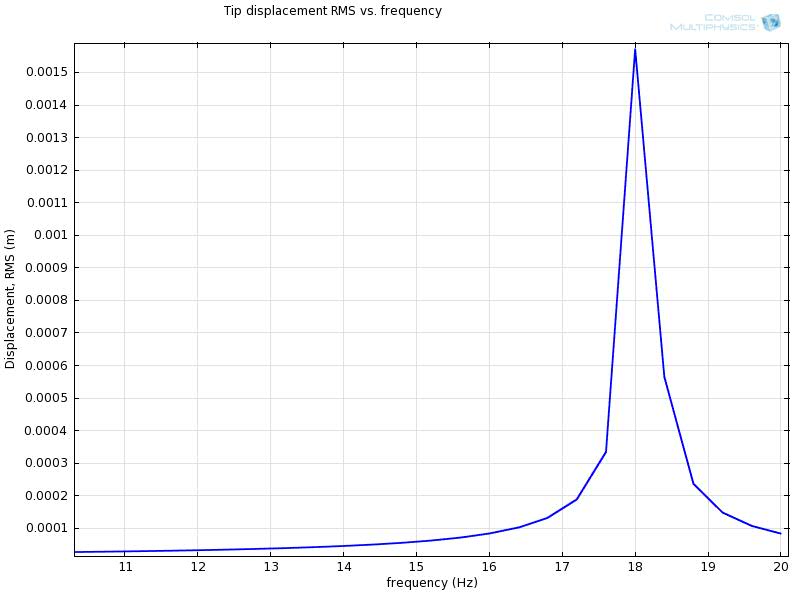

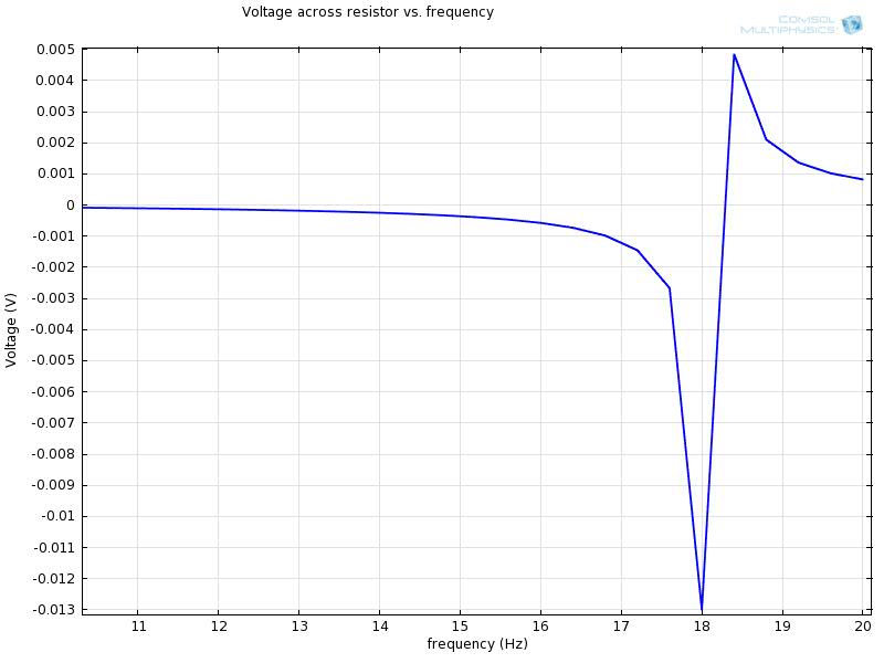

Hi, I am doing the simulation with the cantilever coated by piezo material. When I do the frequency sweep, the cantilever tip displacement and output voltage reach its highest at the resonant frequency. My question is why there is a voltage leap from the negative to positive.
Thank you!
Hi, I am doing the simulation with the cantilever coated by piezo material. When I do the frequency sweep, the cantilever tip displacement and output voltage reach its highest at the resonant frequency. My question is why there is a voltage leap from the negative to positive. Thank you!
Posted: 1 decade ago 27.06.2012, 16:45 MESZ
it has probably to do with the phase lag of your signal which inverses, before the resonance you are driving it, after its the resonance that is ahead of your excitation
Difficult to say more without running a full case
Hi it has probably to do with the phase lag of your signal which inverses, before the resonance you are driving it, after its the resonance that is ahead of your excitation Difficult to say more without running a full case -- Good luck Ivar
Posted: 1 decade ago 27.06.2012, 16:51 MESZ
It is probably a phase issue as Ivar mentioned. Even without piezo effects, before resonance phase angle between force and displacement is 0 and after resonance it is 180 degrees (there is a gradual transition when there is damping).
Nagi Elabbasi
Veryst Engineering
It is probably a phase issue as Ivar mentioned. Even without piezo effects, before resonance phase angle between force and displacement is 0 and after resonance it is 180 degrees (there is a gradual transition when there is damping). Nagi Elabbasi Veryst Engineering
Posted: 1 decade ago 27.06.2012, 17:10 MESZ
indeed for force versus displacement, but if I got it right here it was V out versus force ?
Hi indeed for force versus displacement, but if I got it right here it was V out versus force ? -- Good luck Ivar
Posted: 1 decade ago 27.06.2012, 17:16 MESZ
Is it because Force and the induced Voltage are always in the same phase?
Posted: 1 decade ago 27.06.2012, 19:03 MESZ
if you have a PZT beam, fixed at one end and loaded by a varying force load at the other end, then the force will introduce a deformation of the beam, hence a stress build-up. This stress buildup will generate charges that will populate the electrodes hence induce an electric field across the PZT, this field will vary if the electrodes are free, or grounded (short) or hooked up to some other intermediate or complex impedance. Now the electric field will act on the stiffness tensor and change the deflection hence the response and off we are with a chicken an the egg story: who came first ?
So I would say your foce induces a flexing whcih nitroduces a stress change with induces a potential. But you can loop the other way too ;)
Normally you can simulate the eigenfrequency change if your electrodes are shorted or pen loop, the difference in frequency gives yout the elecric to mechani coupling factor "k"
As you have losses in the PZT and perhaps in the driving circuit of your PZT you will get complex responses so you mst study the behaviour with Bode plots for the amplitude "abs(...)" and the phase "atan2(imag(...),real(...))"
Hi if you have a PZT beam, fixed at one end and loaded by a varying force load at the other end, then the force will introduce a deformation of the beam, hence a stress build-up. This stress buildup will generate charges that will populate the electrodes hence induce an electric field across the PZT, this field will vary if the electrodes are free, or grounded (short) or hooked up to some other intermediate or complex impedance. Now the electric field will act on the stiffness tensor and change the deflection hence the response and off we are with a chicken an the egg story: who came first ? So I would say your foce induces a flexing whcih nitroduces a stress change with induces a potential. But you can loop the other way too ;) Normally you can simulate the eigenfrequency change if your electrodes are shorted or pen loop, the difference in frequency gives yout the elecric to mechani coupling factor "k" As you have losses in the PZT and perhaps in the driving circuit of your PZT you will get complex responses so you mst study the behaviour with Bode plots for the amplitude "abs(...)" and the phase "atan2(imag(...),real(...))" -- Good luck Ivar

Posted: 1 decade ago 22.07.2012, 09:06 MESZ
indeed if you apply a prscribed acceleration, your object CANNOT be fixed these are antogonists. What you can do is to apply a body load of the type "material.rho*my_acceleration" and keep the fixed section "fixed".
I'm neither not fully happy as today I have not found a clean way to apply a shaker type PSD on a model, in a simple way. there are several threads about this on the Forum, try a search
Hi indeed if you apply a prscribed acceleration, your object CANNOT be fixed these are antogonists. What you can do is to apply a body load of the type "material.rho*my_acceleration" and keep the fixed section "fixed". I'm neither not fully happy as today I have not found a clean way to apply a shaker type PSD on a model, in a simple way. there are several threads about this on the Forum, try a search -- Good luck Ivar

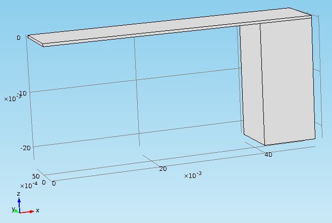

Posted: 1 decade ago 01.08.2012, 06:04 MESZ
Hi Ivar,
From the attached figure, does my model represent a beam subjected to base excitation? (the beam is attached to a big rigid mass). I've applied body load before to the rigid mass but the output voltage generated is maximum at the fifth eigenfreq. If I changed it to prescribed acceleration and applied it on top of the rigid mass, I can see that the maximum value of voltage is at the first eigenfreq (which is theoretically correct according to my understanding)
thanks
Hi Ivar, From the attached figure, does my model represent a beam subjected to base excitation? (the beam is attached to a big rigid mass). I've applied body load before to the rigid mass but the output voltage generated is maximum at the fifth eigenfreq. If I changed it to prescribed acceleration and applied it on top of the rigid mass, I can see that the maximum value of voltage is at the first eigenfreq (which is theoretically correct according to my understanding) thanks

Posted: 1 decade ago 02.08.2012, 20:29 MESZ
from you image, you should not use fixed and acceleration simulatneously, but you must use two roller conditions on two opposite sides of your sqare mass at right angle to the acceleration direction. Be sure you large mass is "large" compared to the beam, and then get the correct estimate of the true load on the beam
100V is not necessarily that much, you can get a sparck (>1kV) easily with a stressed PZT, but this also depends strongly on the impedance you connect up on your PZT
Hi from you image, you should not use fixed and acceleration simulatneously, but you must use two roller conditions on two opposite sides of your sqare mass at right angle to the acceleration direction. Be sure you large mass is "large" compared to the beam, and then get the correct estimate of the true load on the beam 100V is not necessarily that much, you can get a sparck (>1kV) easily with a stressed PZT, but this also depends strongly on the impedance you connect up on your PZT -- Good luck Ivar

Posted: 1 decade ago 12.12.2012, 04:32 MEZ
I've applied body load to represent base excitation, and assigned "added mass" BC at the free end of the cantilever ( to represent tip mass). Howver, it shows that the voltage output at the eigenfreq keeps decreasing as the "added mass" increases. I believe by adding the tip mass, the voltage will be increased.
Thanks
Hi, I've applied body load to represent base excitation, and assigned "added mass" BC at the free end of the cantilever ( to represent tip mass). Howver, it shows that the voltage output at the eigenfreq keeps decreasing as the "added mass" increases. I believe by adding the tip mass, the voltage will be increased. Thanks
Posted: 1 decade ago 12.12.2012, 07:33 MEZ
if you add an "added mass then you must also add a boundary force, as the body load applies ONLY forces to the DOMAIN, not to the added mass that is a separate "fictuous " entitiy do not forget that ;)
Hi if you add an "added mass then you must also add a boundary force, as the body load applies ONLY forces to the DOMAIN, not to the added mass that is a separate "fictuous " entitiy do not forget that ;) -- Good luck Ivar
Posted: 1 decade ago 13.12.2012, 05:45 MEZ
The added mass reduces the natural frequency so the voltage may be dropping because the frequency you specified in the frequency domain analysis is no longer close to the beam’s natural frequency.
Posted: 1 decade ago 13.12.2012, 06:18 MEZ
thanks for the reply. in the frequency analysis, I've specified a range of frequency, the eigenfrequency lies within that range.
Thanks.
Hi, thanks for the reply. in the frequency analysis, I've specified a range of frequency, the eigenfrequency lies within that range. Thanks.
Posted: 1 decade ago 13.12.2012, 18:03 MEZ
Ok, one more thing to check. Conceptually, if you apply a certain body load and you change the structure by adding mass the deformations should in general be lower and also the voltage.
Posted: 1 decade ago 13.12.2012, 18:59 MEZ
Hmm,may I know why? Because from what I understand, Adding tip mass to the structure increases the strain,which eventually increases the deformation. Body load is assigned on the "large" mass attached to the beam and added mass is assigned at the other end of the beam,together with boudary load
Thanks
Hmm,may I know why? Because from what I understand, Adding tip mass to the structure increases the strain,which eventually increases the deformation. Body load is assigned on the "large" mass attached to the beam and added mass is assigned at the other end of the beam,together with boudary load Thanks
