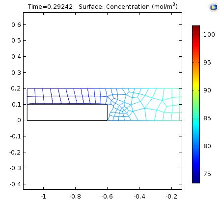

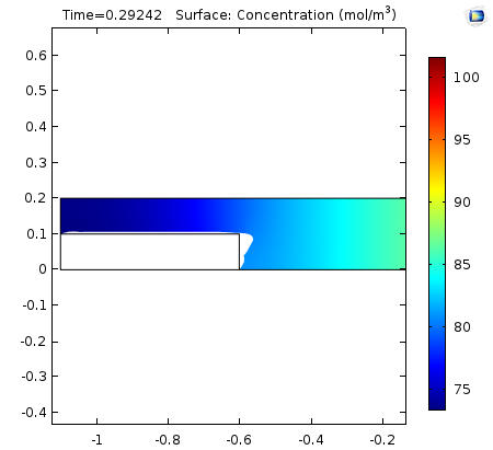

I have built a COMSOL 2D model that uses deformed geometry, where the geometry movement is non uniform. I need to use Automatic Remeshing to update the mesh elements. But after some time (t = 0.29s) it fails.
I tried using moving mesh, mesh refinement as well as segregated solver, but I am unable to get rid of this error. I need to know why this error keeps popping up, and whether there is something that I am missing.
I have given the error, as well as the warning below, and also attached the wireframe and surface plots of the concentration before the error.
Any help would be appreciated.
Thanks.
