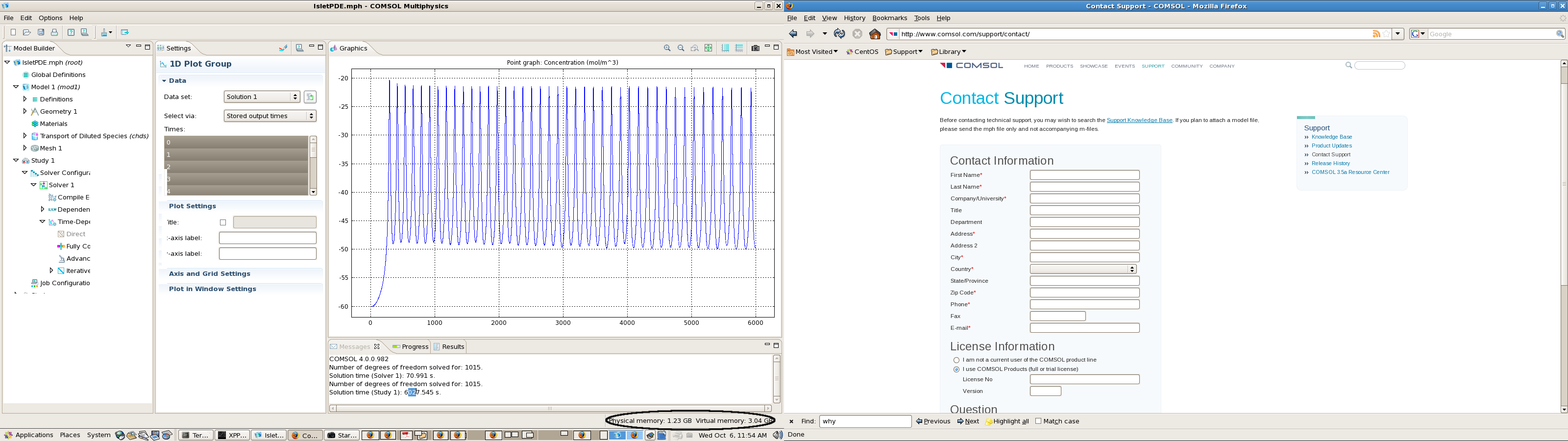

I have plenty of RAM on this machine (16GB) and I am running 64-bit Linux. Oddly, however, Comsol is indicating that it is using almost three times virtual memory as physical memory (screenshot attached). Shouldn't Comsol be using RAM first, rather than so much of virtual memory/swapping?
Could anyone explain to me what might be going on here? I am wondering if there isn't a way to force Comsol to use more of the RAM instead of virtual memory and hopefully get some speedup.
