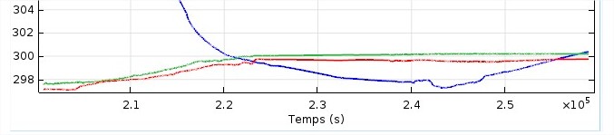

I have a small problem when displaying results. During the simulation, I found that the variation curves move and away from t = 0 and I see only the change to an intermediate interval. So when the simulation is over, I do not get change from time 0 and even in the table associated with the probe, I do not see the data from the beginning. !!!

I do not understand, can you show a screenshot of the thing?

Here in attached a screenshot of my problem. knowing that the computing time that I chose is (0,600,259200). but when viewing the final results, I find myself with this curve that starts from 200,000 s and not from the beginning of the simulation.

There's a limit on how many lines a table can contain. It's 10000 by default - maybe your solver takes more than 10000 steps. You can change the limit in Preferences > Results > Defaults for new tables: Maximum number of rows. For an existing model you can change the limit for a table in the settings in Results > Tables.

Thankyou for your suggestion. Very much satisfied.
