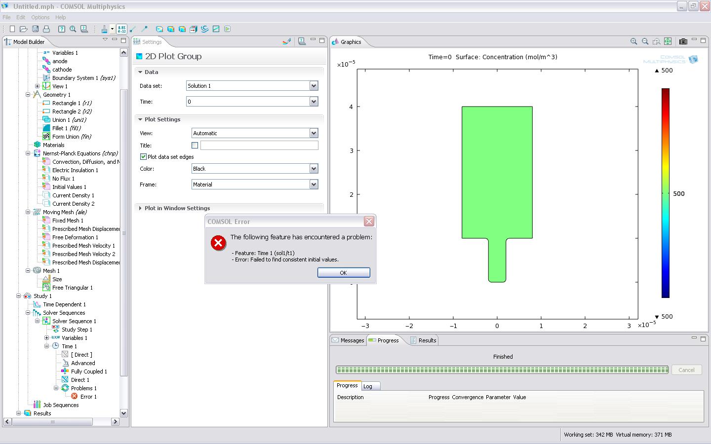

I just started to use comsol for simulation an electroplating process
and to understand the process I tried out Electrochemical Copper Deposition model
after i computed it shown as an attached file
then i see an error in the problem function that
Failed to find consistent initial values.
Singular matrix
could anyone explain about this?
Thank you very much,
Sedtanan
Pardon for my bad english
**i attach a file that i followed the step in pdf file on www.comsol.com/showroom/documentation/model/2112/ (ver 4.0) also thanks again

are you shure that when you impose two current sources and no drain that you have an equilibre in the current flow ?
Failed to find initial conditions is typically there when the BC's and model set-up is not coherent
Hi are you shure that when you impose two current sources and no drain that you have an equilibre in the current flow ? Failed to find initial conditions is typically there when the BC's and model set-up is not coherent -- Good luck Ivar
