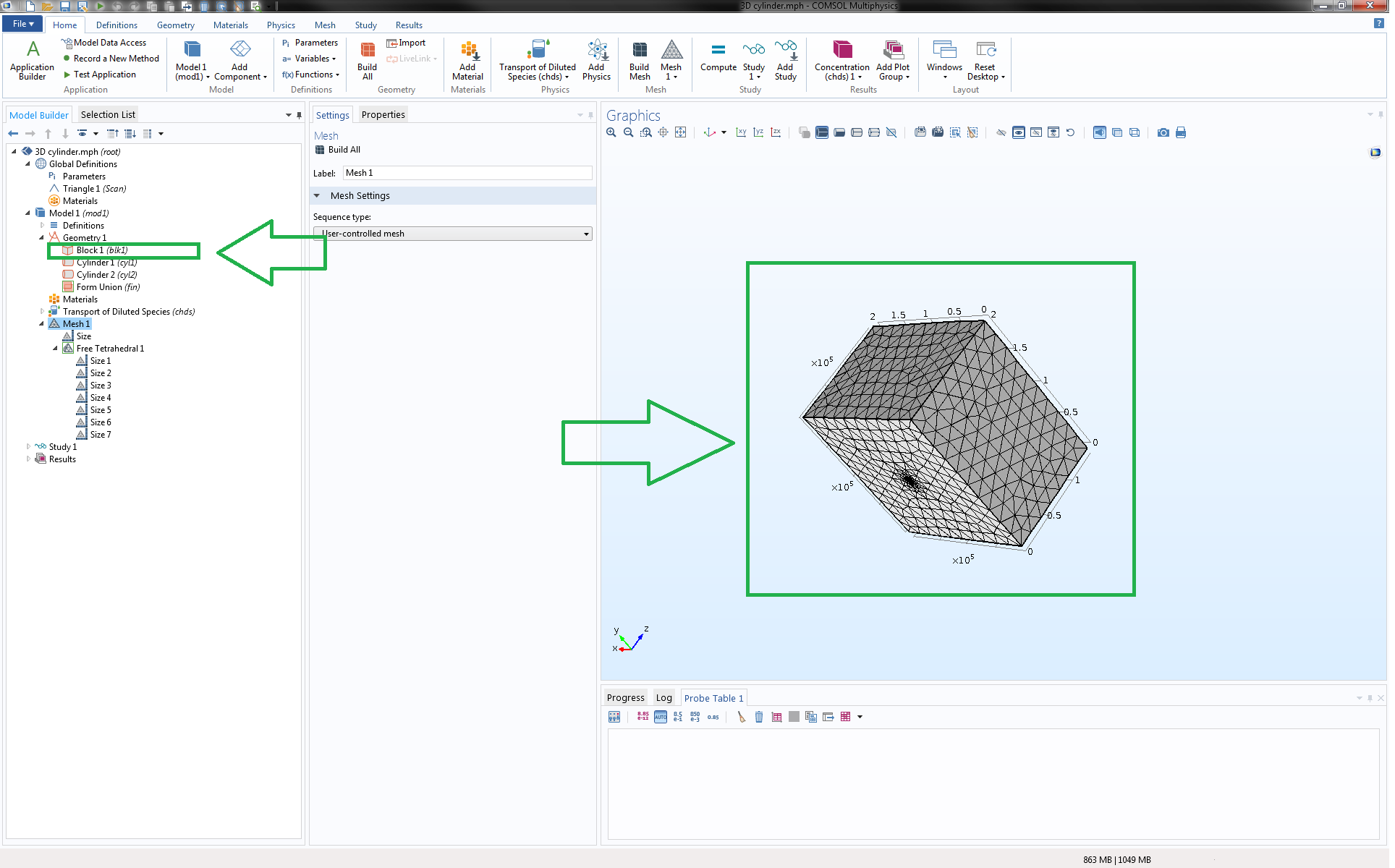

Posted: 10 years ago 01.03.2016, 14:35 GMT-5
See screenshot of your file. Looks like a block to me, regardless of mesh settings :)
See screenshot of your file. Looks like a block to me, regardless of mesh settings :) Jeff

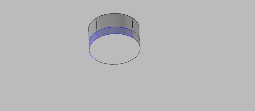

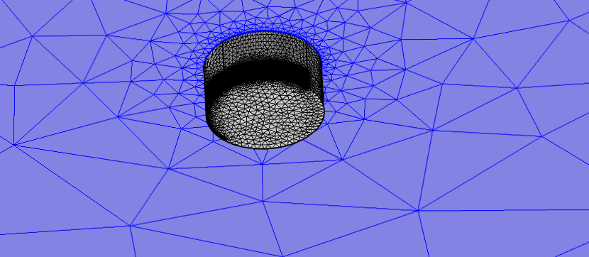

Posted: 10 years ago 01.03.2016, 15:07 GMT-5
Hi Jeff,
Oh I see, sorry, that block is the domain. Actually I am simulating a recessed cylinder ( r= 250 nm). The whole model consists of: a big block as domain and two recessed cylinder. I am interested in the second cylinder and I solving the problem for half it. Please see the zoom in screenshots.
Thanks
