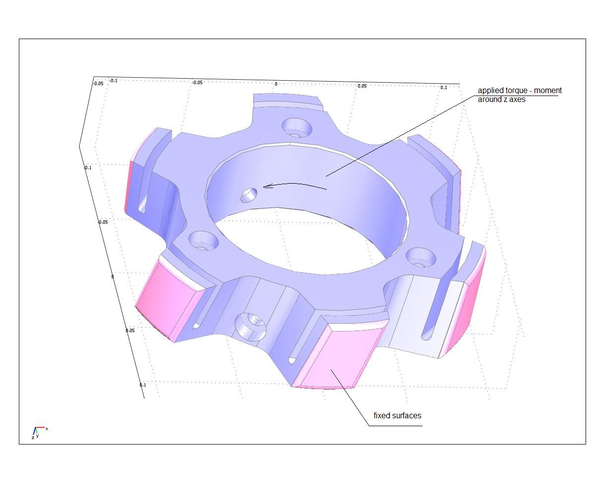

I try to model a ring blocked in the external cylinder. I want to apply the torque on internal surface and fixe external surface (see picture). But in the Multiphysics Structural , solid stress-strain analysis you can apply only load (force) or displacements(Rx, Ry). So, I've calculated a rotations (correspondant to the torque) then displacents Rx, Ry and applied int the boundary. After run the VM stress are too high and the reactive torque on the fixed surfaces is 1000 more than I considered to apply.
Do somebody used the Comsol for the torque load simulation. Please advise. Thank you very much.

You can find a very nice example in the SMEUG.pdf file EXAMPLE: Torsional moment on a cylinder. With all explanations how to apply it, I would suggest to try out the example first.
As rotations are not defined by default in 3D structural, you need to work a little with coordinate transforms, but it works very well.
Hi You can find a very nice example in the SMEUG.pdf file EXAMPLE: Torsional moment on a cylinder. With all explanations how to apply it, I would suggest to try out the example first. As rotations are not defined by default in 3D structural, you need to work a little with coordinate transforms, but it works very well. Good luck Ivar

Thank you for your reply. I've calculated the transformation from the angle of rotation to the coordinate change. I've tested it in Excel firstly and in the Comsol I've got the same displpacements like in Excel. But in Comsol I've got the irrealistique stresses.
I'll looking for this exemple. Thank you Ivar.
Thank you for your reply. I've calculated the transformation from the angle of rotation to the coordinate change. I've tested it in Excel firstly and in the Comsol I've got the same displpacements like in Excel. But in Comsol I've got the irrealistique stresses. I'll looking for this exemple. Thank you Ivar.

Posted: 2 decades ago 06.10.2009, 10:29 GMT-4
If you are going to do a lot of structural as I can see on your image, you should very seriously consider the purchase of the structural module, you will quickly gain time covering the price difference
I hope the explanation below works ok without, but as I understand it there is not much specific to the structural module.
And I hope COMSOL finds it OK to export an excerb of their doc, if not, they know how to suppress it ;)
By the way, some of these docs can also be found on the web with a Google search, albeit I find that less conform to normal (c) standards
Hi If you are going to do a lot of structural as I can see on your image, you should very seriously consider the purchase of the structural module, you will quickly gain time covering the price difference . I hope the explanation below works ok without, but as I understand it there is not much specific to the structural module. And I hope COMSOL finds it OK to export an excerb of their doc, if not, they know how to suppress it ;) By the way, some of these docs can also be found on the web with a Google search, albeit I find that less conform to normal (c) standards Good luck Ivar

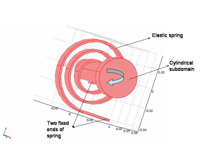

I had gone through the discussion. Iam having one doubt in similar to it. Iam doing a module in comsol on concept of winding and unwinding a elastic spiral spring w.r.t a cylindrical rod in middle of the spring.
Now i want to rotate the rod spherically, so that the spring should wind and unwind.
Here i fixed the two ends of the spring and tried normally in cartesian coordinates. Output obtained is just moving the rod in one direction .
I require information in rotating rod spherically.
pls do the needful help.

If I understand you well, you are in 2D or 3D cartesian and want to define a "rotation" around an axis. Well that is for me rather similar to the case described in the doc, apart that its not a load but a prescribed deplacement you want.
My first try qwould be something like define your axis and a radial vector r=sqrt((x-x0)^2+(y-y0)^2) where x0,y0 is the centre of the axis, and I assume the axis si paralle to"z", if not you would ahve to apply some rotation matrices to the formual o get the correct components, but the principle remains.
Then you can define the angle theta_z=atan2((y-y0),(x-x0)) (or is it the opposite?, I always get it wrong, Murhy I suppose again, pls check).
then you apply a prescribed dispalcement on the x,y components of the cylindrical edge (assumed in the x-y plane) of your mechanical axis and you enforce a displacement relative to theta_z.
You can do this cleaner in the way described, with a secondary coordinate system fromn a workplane defined normal to your ratation axis and with the origine on the axis intersection.
Goos luck
Hi If I understand you well, you are in 2D or 3D cartesian and want to define a "rotation" around an axis. Well that is for me rather similar to the case described in the doc, apart that its not a load but a prescribed deplacement you want. My first try qwould be something like define your axis and a radial vector r=sqrt((x-x0)^2+(y-y0)^2) where x0,y0 is the centre of the axis, and I assume the axis si paralle to"z", if not you would ahve to apply some rotation matrices to the formual o get the correct components, but the principle remains. Then you can define the angle theta_z=atan2((y-y0),(x-x0)) (or is it the opposite?, I always get it wrong, Murhy I suppose again, pls check). then you apply a prescribed dispalcement on the x,y components of the cylindrical edge (assumed in the x-y plane) of your mechanical axis and you enforce a displacement relative to theta_z. You can do this cleaner in the way described, with a secondary coordinate system fromn a workplane defined normal to your ratation axis and with the origine on the axis intersection. Goos luck Ivar

Thank u for reply.Iam not getting in correct way to do the model so
I attached my geometrical model here, that is in 3D space dimension .
The two ends of elasticspring are fixed by using holes kept on it. In middle of the spring a cylindrical subdomain is added.
Now the subdomain should rotate with the axis of rotation, and due to that there should be deformation in the spring(strain calculation due to angulardisplacement) i.e, spring winds and unwinds.
This is my problem. I didnt understand how to do this process(analysing) in Comsol.
I followed comsol multiphysics-structural mechanics-solid-stress/strain-static analysis.
I request u to send an idea how to do this process.

Well basically a whatchmakers spiral and the momentum wheel.
For me it applies well to the SMEUG.PDF example (the "Structural Mechanics Module, User's Guide", see page of V3.5a page 69++ or just scan for "Torsional". For me its in .../comsol35a/doc/sme/).
I agree that the explanations are not crystal clear, and I still have a unit issue I'm not happy with (at least in V3.5a, when I follow the explanations literally) but the rotation is there when I model it, even if I cannot yet get the reaction moment to match my applied moment.
One of the items is that the "cylindrical coordinate" check used to define the new user coordinate system generates a specific rotation matrix (dump your model as a M file and check the coordinate section) that does the trick, the "geom2" workplane is only there as a placeholder to access this option for the new corrdinate transform.
If you want to force and fix the rotation axis, then I would suggest to add two points along the axis on the top/bottom surface of your shaft, and enforce a displacement Rx=0 Ry=0 Rz=0 on both points. It's slightly crude as a "point constraint" but works still quite well.
Hi Well basically a whatchmakers spiral and the momentum wheel. For me it applies well to the SMEUG.PDF example (the "Structural Mechanics Module, User's Guide", see page of V3.5a page 69++ or just scan for "Torsional". For me its in .../comsol35a/doc/sme/). I agree that the explanations are not crystal clear, and I still have a unit issue I'm not happy with (at least in V3.5a, when I follow the explanations literally) but the rotation is there when I model it, even if I cannot yet get the reaction moment to match my applied moment. One of the items is that the "cylindrical coordinate" check used to define the new user coordinate system generates a specific rotation matrix (dump your model as a M file and check the coordinate section) that does the trick, the "geom2" workplane is only there as a placeholder to access this option for the new corrdinate transform. If you want to force and fix the rotation axis, then I would suggest to add two points along the axis on the top/bottom surface of your shaft, and enforce a displacement Rx=0 Ry=0 Rz=0 on both points. It's slightly crude as a "point constraint" but works still quite well. Good luck Ivar
