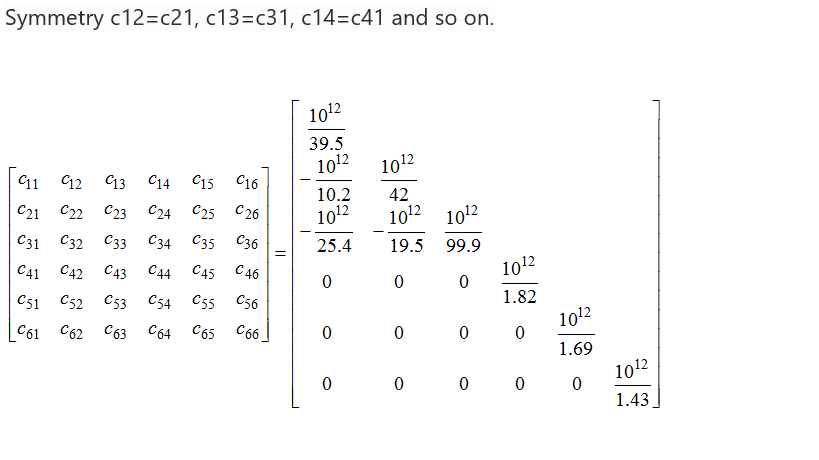

Posted: 8 years ago 04.05.2017, 00:55 GMT-4
Can you please kindly mark all the individual components of the elastic matrix (cE unit is Pa) (6*6).
Posted: 8 years ago 04.05.2017, 02:55 GMT-4
Please find the answer in attached file. To get more information, I recommend to visit this link as well:

Hi Please find the answer in attached file. To get more information, I recommend to visit this link as well: https://www.comsol.com/community/forums/general/thread/27159/

Posted: 8 years ago 05.05.2017, 14:40 GMT-4
When i am putting the matrix element of Elastic Matrix (cE unit is Pa) and Coupling Matrix (e unit C/m^2) in stress charge form in material contents section, it turns yellow color and showing "inconsistent unit". The used matrix elements are given below.
Elastic Matrix (cE unit is Pa): {10^12/39.5[Pa],-10^12/10.2[Pa],-10^12/25.4[Pa],0[Pa],0[Pa],0[Pa],-10^12/10.2[Pa],10^12/42[Pa],-10^12/19.5[Pa],0[Pa], 0[Pa],0[Pa],-10^12/25.4[Pa],-10^12/19.5[Pa],10^12/99.9[Pa],0[Pa],0[Pa],0[Pa],0[Pa], 0[Pa],0[Pa],10^12/1.82[Pa],0[Pa],0[Pa],0[Pa],0[Pa],0[Pa],0[Pa],10^12/1.69[Pa],0[Pa],0[Pa], 0[Pa],0[Pa],0[Pa],0[Pa],10^12/1.43[Pa]}
Coupling Matrix (e): {0[C/m^2], 0[C/m^2], 23*3/1000[C/m^2], 0[C/m^2], 0[C/m^2], 23*3/1000[C/m^2], 0[C/m^2], 0[C/m^2], -33*3/1000[C/m^2], 0[C/m^2], -23*3/1000[C/m^2], 0[C/m^2], -27*3/1000[C/m^2], 0[C/m^2], 0[C/m^2], 0[C/m^2], 0[C/m^2], 0[C/m^2]
It will be a pleasure if you kindly help me to overcome this difficulty.
When i am putting the matrix element of Elastic Matrix (cE unit is Pa) and Coupling Matrix (e unit C/m^2) in stress charge form in material contents section, it turns yellow color and showing "inconsistent unit". The used matrix elements are given below. Elastic Matrix (cE unit is Pa): {10^12/39.5[Pa],-10^12/10.2[Pa],-10^12/25.4[Pa],0[Pa],0[Pa],0[Pa],-10^12/10.2[Pa],10^12/42[Pa],-10^12/19.5[Pa],0[Pa], 0[Pa],0[Pa],-10^12/25.4[Pa],-10^12/19.5[Pa],10^12/99.9[Pa],0[Pa],0[Pa],0[Pa],0[Pa], 0[Pa],0[Pa],10^12/1.82[Pa],0[Pa],0[Pa],0[Pa],0[Pa],0[Pa],0[Pa],10^12/1.69[Pa],0[Pa],0[Pa], 0[Pa],0[Pa],0[Pa],0[Pa],10^12/1.43[Pa]} Coupling Matrix (e): {0[C/m^2], 0[C/m^2], 23*3/1000[C/m^2], 0[C/m^2], 0[C/m^2], 23*3/1000[C/m^2], 0[C/m^2], 0[C/m^2], -33*3/1000[C/m^2], 0[C/m^2], -23*3/1000[C/m^2], 0[C/m^2], -27*3/1000[C/m^2], 0[C/m^2], 0[C/m^2], 0[C/m^2], 0[C/m^2], 0[C/m^2] It will be a pleasure if you kindly help me to overcome this difficulty.
Posted: 8 years ago 05.05.2017, 23:46 GMT-4
There is no need to put units as mentioned in previous comments
