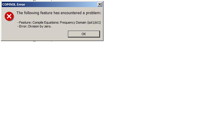

I have done the models. Now, I am making another simulation about eddy current testing. This is also a 2D axisymmetric model. Two multi-turn coils are used. One is used for exciting and another for detecting. They are both located at the inside of a tube. I got a error when I computed. The error is`division by zero`. I am confused about it.
Attached is my model and the error.

Hi, Ivar, thank you for your information. I have done the models. Now, I am making another simulation about eddy current testing. This is also a 2D axisymmetric model. Two multi-turn coils are used. One is used for exciting and another for detecting. They are both located at the inside of a tube. I got a error when I computed. The error is`division by zero`. I am confused about it. Attached is my model and the error. Looking forward the reply. Best wishes.

not sure its linked but you have missed the "acoil" section value for coil "2", but as there is no current either it might not be it !?
now it generates a mass matrix = 0 error but it calculates partly, the mass error comes from a (probaby old leftover frequency solver seuqnce in your Study section)
In V4.0 and 4.0a you should carefully delete old solvers before making new ones, these early COMSOL versions are not fully capable of cleaning up "automatically.
So by correcting the coil section and adding a curent, and regenerating the solver it should work, but I canniot tell like thit if its "correct ;)

Hi not sure its linked but you have missed the "acoil" section value for coil "2", but as there is no current either it might not be it !? now it generates a mass matrix = 0 error but it calculates partly, the mass error comes from a (probaby old leftover frequency solver seuqnce in your Study section) In V4.0 and 4.0a you should carefully delete old solvers before making new ones, these early COMSOL versions are not fully capable of cleaning up "automatically. So by correcting the coil section and adding a curent, and regenerating the solver it should work, but I canniot tell like thit if its "correct ;) Always carefully validate and verify your models at least agains a simple analytical solution -- Good luck Ivar

Ivar, thank you for your advice. Now there is no error. I will more careful in the further simulations.
