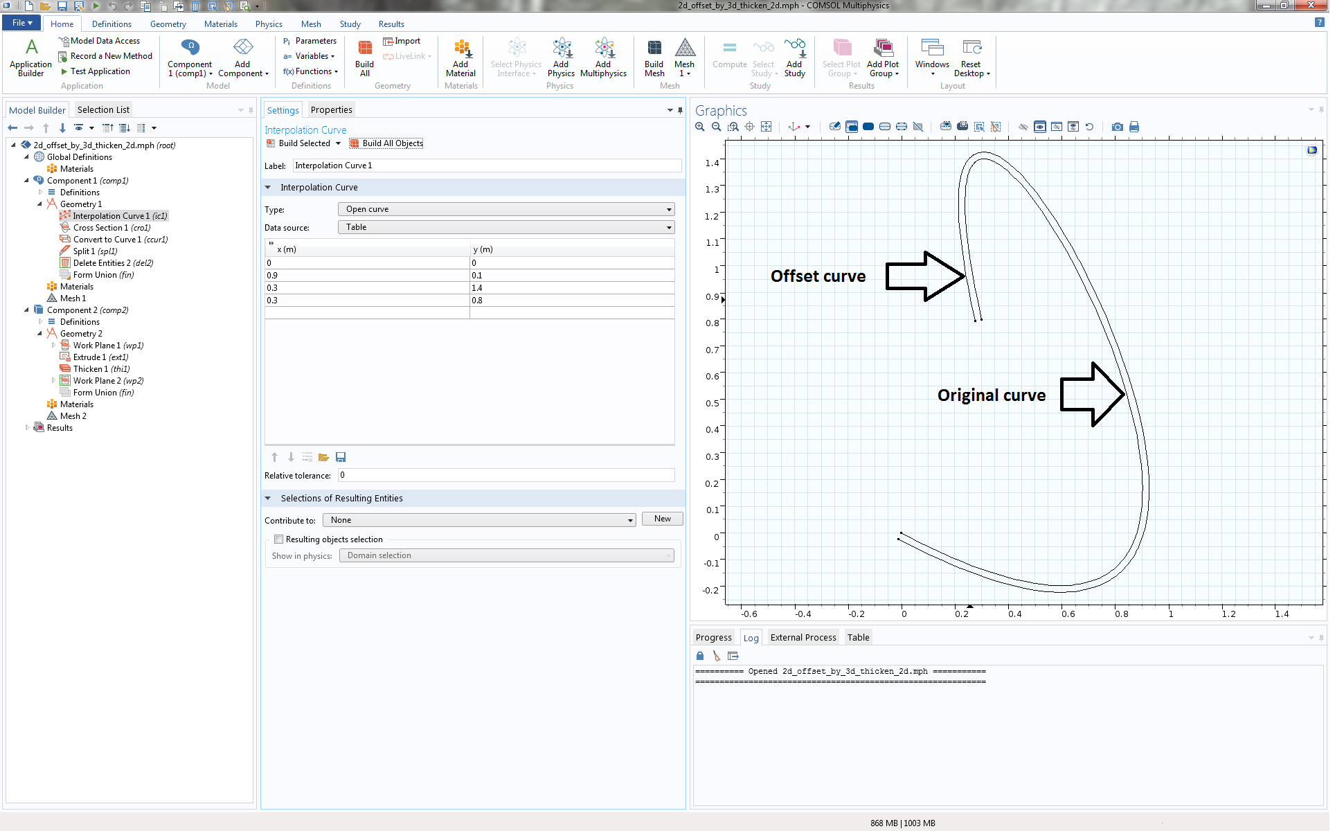

There is a way to use the 3D thickening capability I mentioned earlier to handle your 2D situation. This method will work even for non-trivial 2D shapes (Scaling only works for very special cases).
The idea is to add a 3D component to your model, bring your 2D curve into a work plane in that 3D component, extrude that curve into a surface, thicken that surface into a solid, add a work plane that intersects that solid, and then back in the original 2D component you use the cross section capability to bring in the intersection of the solid and that last work plane.
This method is illustrated in the attached file. Again, please note that it requires the Design Module.
I hope this helps.
