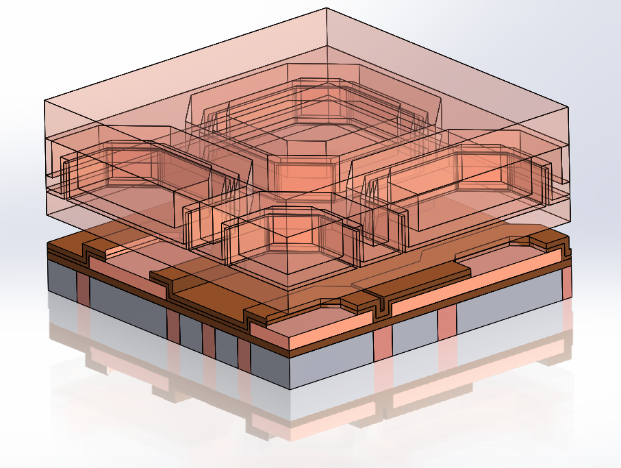

Attached there is a picture of the cross section of the device. It shows 1/4 of the chip if the octagonal pads of the sensor, on top, and the pads of the readout chip exposed on bottom.
