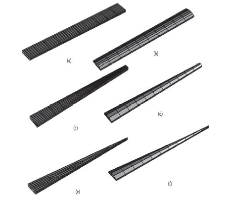

with all due respect i need some help regarding cross section in comsol multiphysics. i got some problem related to different geometries and cross sections . i tried harder to create trepezoidal form but i failed and didn't got as i want to get . so help to make through this and i have jpg of cross sections .

You can create such geometries by using the lofting capability found in the Design Module:
www.comsol.com/design-module
Hello Sahrukh, You can create such geometries by using the lofting capability found in the Design Module: https://www.comsol.com/design-module Best regards, Jeff

thank u for your response can u plz make any one of them geomatry so that i can learn from your model.
sir thank u for your response can u plz make any one of them geomatry so that i can learn from your model.
Posted: 9 years ago 06.05.2016, 16:54 GMT-4
If you do not have a license for the Design Module, please contact your COMSOL representative to request an electronic copy of its documentation. It is quite detailed and includes examples.
If you do not have a license for the Design Module, please contact your COMSOL representative to request an electronic copy of its documentation. It is quite detailed and includes examples. Best regards, Jeff

thank u so much for helping me , i have made all the cross section of trapezium but i got one problem regarding voltage . how to evaluate voltage of cantilever,which physics i choose to evaluate this potential .
plz help me i stuck in this problem i didn't get potentiona and i m using emi physics.
