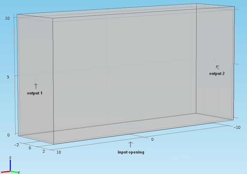

I am trying to build a simulation of a gas nozzle (1 bar pressure, Helium) introducing a gas into a small cell (10mmx20mmx30mm), which has three small (around 1mm or 500µm diameter) openings - one for the input nozzle, two which allow the gas to leak out.

First of all, I modeled the box with six work planes, three of them have a spherical hole (created by the boolean "difference" operator) (one input, two output).
Then I built the gas inside and outside the box with another work plane and a extrusion, so the box is completely "immersed" in the gas work plane.
