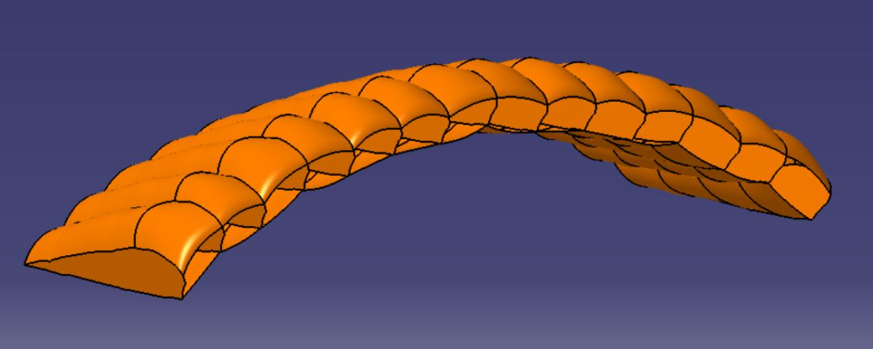

I am trying to perform a CFD flow field simulation of a 3D parachute to find its lift and drag. The geometry model is imported from a CAD software as surfaces only (no thickness). I attached one picture of how it looks like. In order to make the simulation, I created the computational domain (box) big enough to neglect the boundary effects (I saw in a post from an airfoil SST model that a recommended value of 100 chord-lengths toward all sides is enough). For the physics, I am using the SST turbulence model with inlet (velocity input), outlet (pressure output) and symmetry (box lateral sides) boundary conditions. I used an interior wall boundary condition on the surfaces of the parachute with no slip condition. For the mesh, I have tetahedrals for the domains and prisms for the boundary layer over the parachute surfaces. After running the simulation, I visualized clearly the vortices created in the interior of the parachute. However, when calculating the surface integrals to determine lift and drag (I saw in a comsol blog to use spf.T_stress to calculate lift and drag at the correspondent axis direction), I am getting nonsense values (my drag is on the opposite direction resulting in a propulsive force). For sanity checks, I was also trying to see how the pressure differs on the parachute surfaces from the inside and outside but I only see the same values on both sides.
