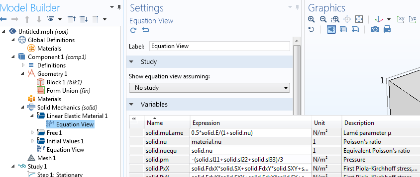

What is solid.pm exactly in Comsol Solid Mechanics?
Posted 19.05.2016, 10:08 GMT-4 Version 5.2 2 Replies
I know it is Pressure but what is the difference between this one and stress or Piola stress? I could not find it in the manual!
