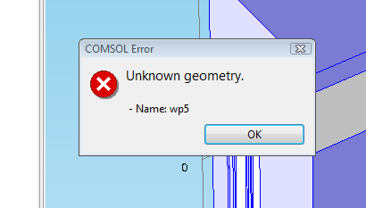

what I want to do ist to run a COMSOL model in Matlab.
Therefore I tried to reset the history in Comsol 4.0a, to get the filesize of the corresponding m-file as small as possible.
But it isn´t possible to reset the history because of the following error message:
"Unknown geometry, Name: wp5" (see the attached file)
wp5 seems to be a workplane. Even if I disable wp5 and rebuild the geometry the error still exists.

I also have this problem. Does anyone know why this happens? Also, it seems to only have a problem with the very last work plane. So if you were to delete wp5, then it would complain about wp4 instead.

Update: I removed all the workplanes until it worked. It seems that comsol will reset history if you only have workplanes up to wp2. This doesn't work if you have only 2 workplanes but one of them is named wp3 or higher.
