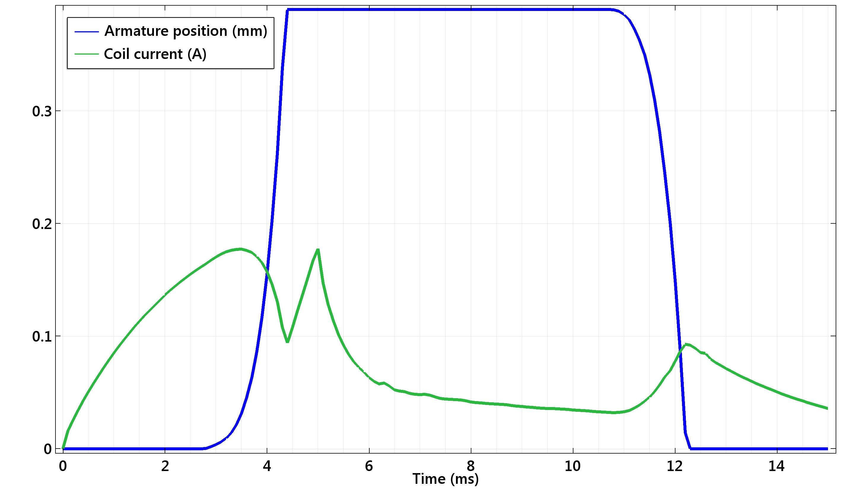

Hi Nirmal,
I have been trying to simulate the movement of an armature due to the electromagnetic force produced by permanent magnets and a multi - turn coil. The other forces acting on the plunger is a spring force, but the spring is also preloaded.
I am not sure if I define the forces correctly, but the plunger is moving and interfering with the stator.
Can you help me to resolve this issue?
If you need more information, I can prepare something and share it with you.
Pavlos.
Hi Nirmal, I have been trying to simulate the movement of an armature due to the electromagnetic force produced by permanent magnets and a multi - turn coil. The other forces acting on the plunger is a spring force, but the spring is also preloaded. I am not sure if I define the forces correctly, but the plunger is moving and interfering with the stator. Can you help me to resolve this issue? If you need more information, I can prepare something and share it with you. Regards, Pavlos.

Posted: 9 years ago 20.06.2016, 11:31 GMT-4
Hi all,
First of all, I would to like to thank you both for the advice. I tried to implement the same physics as described in here : www.comsol.com/blogs/part-2-model-a-linear-electromagnetic-plunger-with-a-blocker/
But it seems that I am not defining the parameters and the event conditions correctly.
Another way I tried to solve this problem is by introducing a stop condition in my study (for example I setup the study to stop when the displacement is equal or greater than 17 mm).
Kind regards,
Pavlos Zairis
Hi all, First of all, I would to like to thank you both for the advice. I tried to implement the same physics as described in here : https://www.comsol.com/blogs/part-2-model-a-linear-electromagnetic-plunger-with-a-blocker/ But it seems that I am not defining the parameters and the event conditions correctly. Another way I tried to solve this problem is by introducing a stop condition in my study (for example I setup the study to stop when the displacement is equal or greater than 17 mm). Kind regards, Pavlos Zairis
