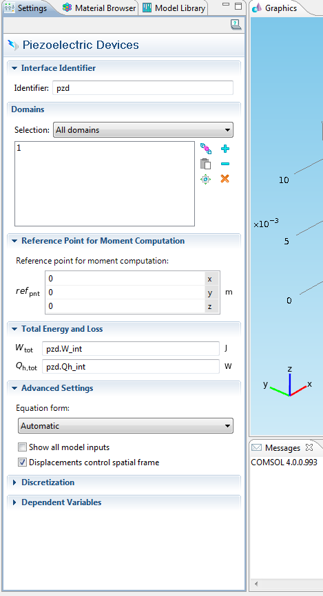

I'm simulating with the pzd module the behavior of a piezoelectric transducer, in 3D. In particular, I'm using the Frequency Domain Study, to calculate vibrations as a function of input voltage frequency. It works well, but now I want to calculate the electric impedance of the transducer. To do this, I need to know the current that flows in the piezo boundary in which I set the input voltage.
I've tried to create a boundary probe, setting the type "Integral", and creating an expression that calculate the total current, as you can see in the attached image.
I'd like to know if the setting is right, and how can I call this probe in a Global 1D Plot.

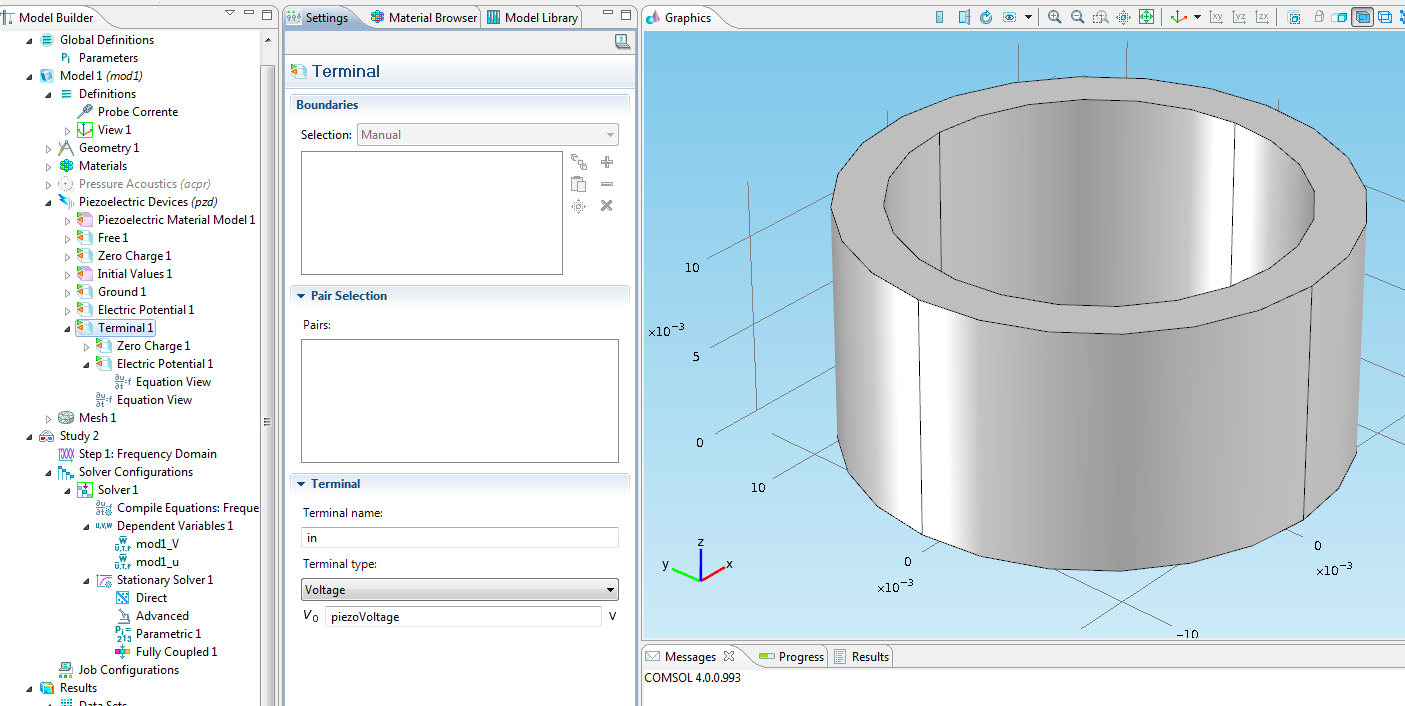

Unfortunately, this section is not present as you can see in the attached image, and otherwise there's no "port" for boundaries condition. I find only "terminal" and I'm not sure that's the same thing. In addition to this, if I select the Terminal Condition, the boundary selection box is blank, and I can't select anything.
The fact is that, when I had the trial of version 3.5, I found an example in which current is calculated by integration of current density in the boundary selected with my voltage source. I'd like to create the same thing here.

not all examples are in the 4.0 version, far better in the 4.1 (being shipped these days, check with your local rep), normally you can also integrate the current density over the boundary in v4, ou define the integration as an operator in the definitions node, and you can name it in a variable also in the Definitions node)
