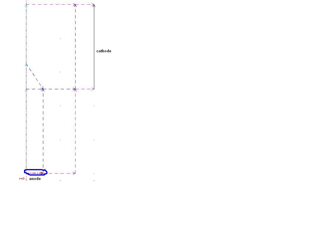

Im using physics BC's (ground, electric potential...) I wasn't aware of the existance of lumped port/terminal BC's. Where can I find those?
I think I'm making some progress by refining the mesh.
I set up a simpler model of my problem (so that it doenst take so much memory) and tried different meshes. Both in 3D and ax sym 2D.
The best result i got in 3D was: anodic current 0.808 A, cathodic current: 0.695A. As you can see they differ 0.1 A, but it tells me that the current must be between those two values (0.7,08)
Now, I do the 2D ax sym model, and I refine the mesh as much as I can, ending up with 0.792 A for the cathodic current. (may be right)
However, in 2D I don't know how to calculate the anodic current since it is the integral of a line parallel to the r axis.
In this case I cannot multiply by 2*pi*r (see attached pic). Any ideas?

heres the pic.

NEVERTHELESS, total current should match (as in any series circuit) (integral of the current densities of the anode for all its surface, should equal the intergral of the current densities of the cathode for all its surface).
##Dear Antonio, I suggested to you to check the current densities just to see how smooth is your J along the boundaries!!
Of course you can!! Why not?? The revolution of (2*pi*R) of this line which is parallel to the axis would give you a cylinder surface!! NO??
I have built the same model including your geometry (I am sorry but the 3.2 is in the Comsol museum ;-) )
And the currents are
1.542469 A for the top electrode.
1.542634 A for the bottom electrode.
Good luck man,
